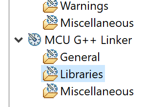

how can these problems be solved? in Project -> Properties -> C/C++ Build -> Settings ->MCU GCC Compiler ->Include Paths .... links seems to be present . .

Create a new eclipse workspace and open (import) your project in that workspace. Refresh, build.
If this won't help then either the copy is not good or the machines are not identical.
2023-12-24 4:27 AM
ld.exe is linker then your issue isnt include or compile.
You write project created in TGFX no IDE. This projects isnt perfect for migrate.
But my tip on new PC you place project on other folder and this corrupt library config...
