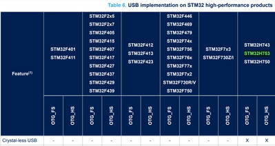

  • Although H753 is supported in the H743 example code, hardware differences may require changes.
  • ST support (FBL) suggested checking the linker script (*.ld) and ensuring memory sections match the STM32H753I-EVAL2 layout.
  • After updating the linker script and startup file to match the correct hardware:
    • Pausing and stopping playback worked as expected.
    • Only playback completion still triggers the audio looping problem.
