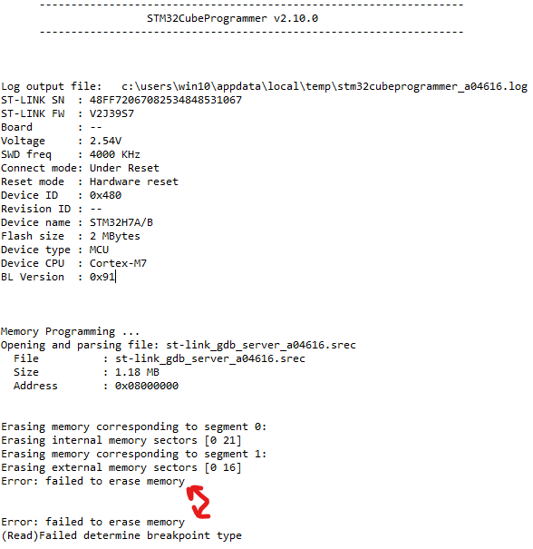

Hi @Emilmart​ I have similir problem. Can you support me please?
I am using below development tools
MCU: STM32H7B3IIT6
IDE: STM32CubeIDE Version: 1.8.0
GUI: TouchGFX Version: 4.18.1
SDRAM: IS45S16800F-7CTLA1-TR
FLASH: MX25LM51245GMI00
I have failure detail below.
Do you have any solution? I need your support.
GChau.2
I had similar issue, sinced I am using ST/LINK V2 instead of nucleo SWD it works for me using the same external loader.
Hope it could help you.
