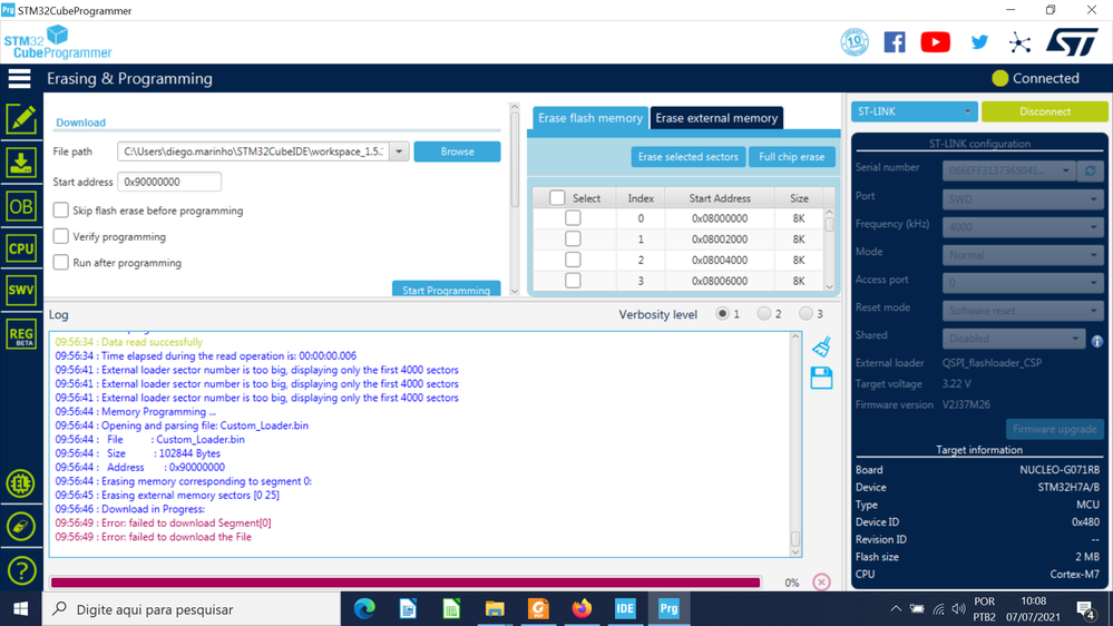

Hi everyone,
I’m working on a custom display board with a STM32H7A3 MCU and a MX66LM1G45G 128Mb OSPI flash. I have build a custom external loader following ST tutorial, with H7 params. I use JTAG to flash.
When it comes to use my .stldr custom loader in CubeIDE or CubeProgrammer (v2.7), it fails.
Here’s what’s CubeProgrammer says when I try to flash my .bin app (touchgfx project) using the external loader:
w ap 0 @0x90000000 0x000D083C bytes Data 0x00000000 // Error: failed to download Segment[1]
With CubeIDE using the external loader, it also fails at Segment[1]
(see full logs attached)
When I try to read a data at 0x90000000 with CubeProgrammer, it also fails (see file log_cubeprogrammer_ReadData.log attached)
I have successfully tested my OSPI functions in the main.c of the external loader (writing/reading/erasing) on my board (without the external loader linker modifications).
In my TouchGFX applicative project I implemented the same OSPI functions and was also able to read datas in memory mapped mode.
I’m not sure about the linker part in my external loader, and my guess is that the problem comes from there. I’m not sure at which adress I should store the external loader code, considering that my STM32H7A3 has some AXI_SRAM (0x24000000)/ AHB_SRAM (0x30000000) by default in STM32H7A3ZITX_FLASH.ld. The RAM is at 0x20000000 in this linker and is only 128KB (not enough for the external loader code), so in the end I followed the example for the H7 which says to store the loader code at 0x24000004 (same RAM origin and size than my TouchGFX project though).
With that linker config I’m able to go at the end of my system Initialisation (Init()) in Loader_Src.c in debug mode.
It may not be that but here are my linkers for the external loader and for the TouchGFX project:

Hi in the linker instead of using the Init as entry point like in the example I kept the Reset_Handler as entry point, with modifying the startup file for redirecting to the Init instead of the main
It seems that some peripheral aren't properly resetting but couldn't figure which ones. I met then other problems but l suggest you to use UART for debug purpose

Emilmart
Senior
Well it seems that the cube programmer logs that are uploaded in the main post are not correct because I found out that I have a different log if I erase the chip fully (old flash code with test code was still there) before using the external loader in cubeprogrammer.
It appears that my Init function fail.
You'll find the correct log here :

Did not work @Emilmart​ . When I use the STM32CubeProgrammer to write the custom loader from memory position 0x90000000, I see on the oscilloscope that the Init function is executed (MX_OCTOSPI1_Init, Reset and MemoryMappedMode), then the Write function is executed. But at no time the SectorErase or MassErase function is executed and then the following error happens.
0693W00000Bd3knQAB.pngCan anyone explain to me what is happening?
