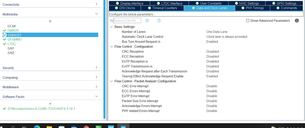

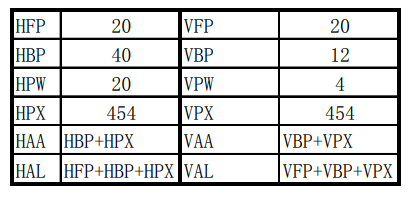

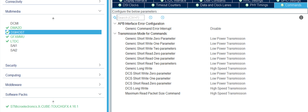

I am trying to drive 454*454 px amoled lcd with stm32l4r9 mcu and the image cannot be displayed properly. I am using the cubemx settings and the desired settings according to lcd datasheet. Any advise ?

‎2022-03-09 2:54 AM
You show only RGB definition, but if your interface is DSI then need next right configuration in stm DSI bridge part.

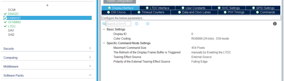

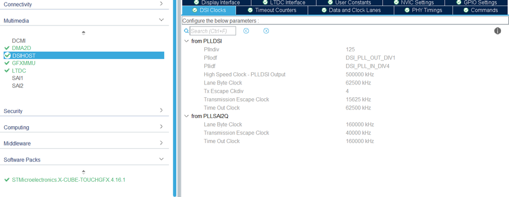

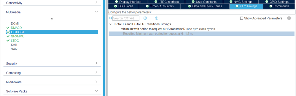

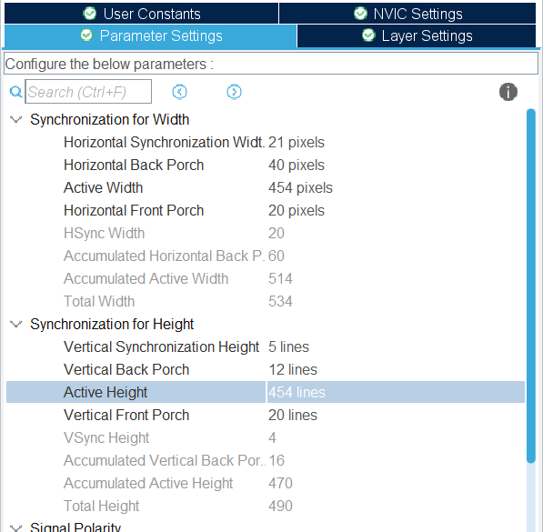

‎2022-03-09 3:01 AM
Ok, i have added some settings screenshots below:
‎2022-03-09 3:43 AM
How DSI mode your display support , how you use ?
‎2022-03-09 4:09 AM
It is a MIPI-DSI amoled lcd, i have sent the link below:
https://www.panelook.com/E1394AA65.A_EDO_1.39_OLED_overview_44496.html
