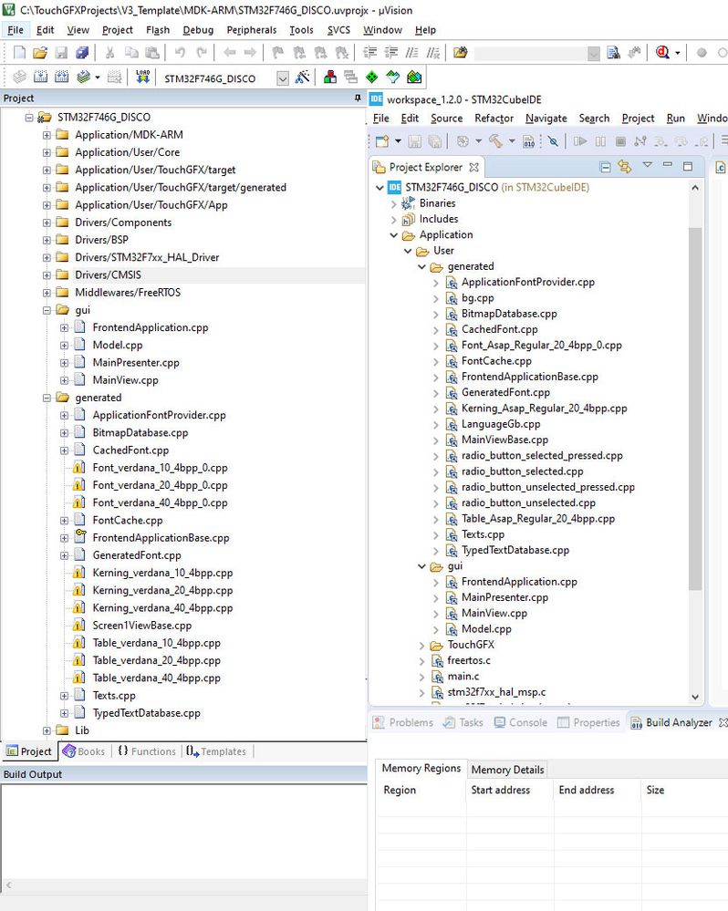

There is also an issue when TouchGFX generates code for Keil. The Keil names for for the generated files are not correct and also missing files.
The image shows Keil on the left column with some errors indicating the files can't be found. I had to delete the Screen1Presenter.cpp and Screen1View.cpp, then add existing files MainPresenter.cpp and MainView.cpp in the gui folder. Then compiled and saw the other errors in the generated folder, so I gave up. Hopefully you guys have an update soon.

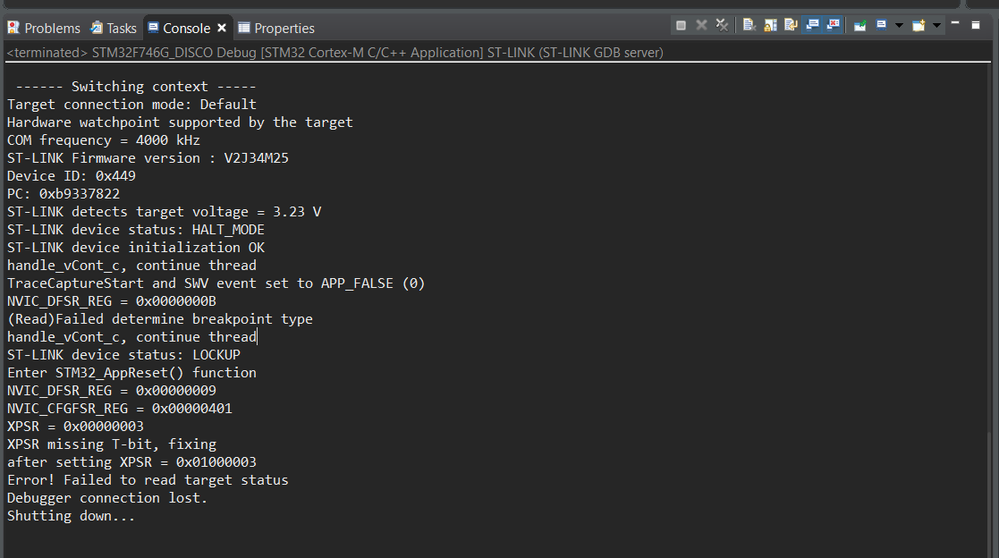

Hi @Martin KJELDSEN​ I created a project for STM32F7 Dico board via Touchgfx designer. Then I open the project in STM32CUBEIDE. It compiles fine but when I try to debug I am having issues. Log attached below.
0690X00000BwZLEQA3.pngP.S. I do not get this issue if I create a project using STM32CUBEIDE as the starting point.
Your help with this is much appreciated. @scottSD​ @HP​  have you guys come across this?

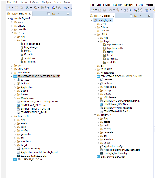

0690X00000BwdahQAB.pngApparently I am a confused when stating the Project File Structure is different. Here is some clarification.
When I create a project in TouchGFX Designer and import it into CubeIDE the project structure is not what I am used to seeing.
  1. The original project name is shown at the top of Project Explorer (right image). However when I select or highlight the name, the build hammer is grayed out. I cannot build that project.
  2. CubeIDE created a project (highlighted in left image) that has a very generic name. This project can be built. But the project name is always STM32F746G_DISCO. The .elf or .bin files generated by CubeIDE retain this name.
  3. CubeIDE creates a link to the .ioc file originally created by TouchGFX Designer.
Most of this can be worked through, but I am very concerned that the project and resulting products (ie .elf and .bin files) naming has changed.
I still do not understand why CubeMX does not generate all of the files needed to support the configuration entered.
If I try to edit the original .ioc file, not the link, I get an error that states Must be projects active.ioc file. Then it tells me the active file is the original project name.ioc
However CubeIDE renamed the file to STM32F746G_DISCO.

I experienced very similar things when first creating the project in TouchGFX and then trying to import it into STM32CubeIDE. I highly recommend watching this video:
https://www.youtube.com/watch?v=o42r4xXOnbo
It shows you how to setup a "custom" board, but you can just choose the 746disco board and follow how the person created their project. This is what got me on track to a working setup.
