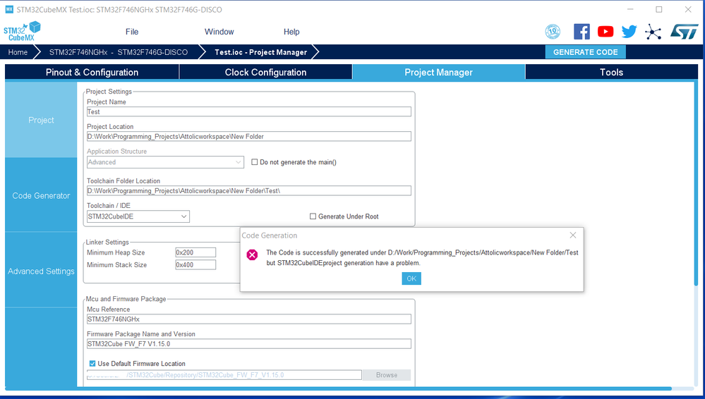

Ok Thanks Martin..While we are discussing this I am also struggling to generate code for STM32CUBEIDE using CUBEMX. I get the following error. Not sure if it is reported already?0690X00000BwjjLQAR.png
Thanks
I've seen this before. It's because you are using a 32-bit version of either CubeMX or Java. Can you check that?
If you hit windowskey and enter "Configure Java" you may get a configuration panel to tell you which is the active java version (you may have multiple installed).
This will indeed cause issues with CubeMX code generation.
Also try deleting "C:\users\zula\.stm32cubeide"
/Martin
