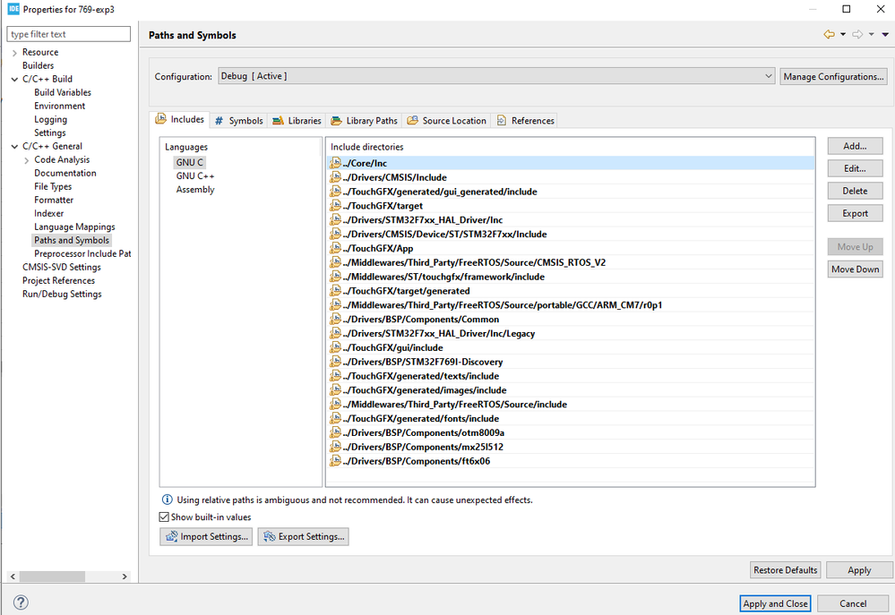

Yes, you don't have but there is included directories in properties, so you must to open touchGFX from win explorer:0690X00000BwRwHQAV.png
About RTOS do you have anything in "/Middlewares/Third_Party/FreeRTOS/Source/CMSIS_RTOS_V2" folder ??
Yes that is setup in the Includes.

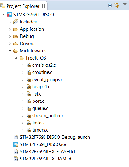

However,.....I don't have "third party" in Middlewares in the Project Explorer:

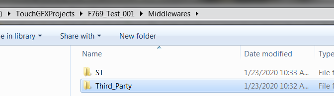

"Third party" is in Middlewares but folder up, so cubeIDE use ../Middlewares/Third_Party/FreeRTOS/Source/CMSIS_RTOS_V2.

I see the files in Windows Explorer in the original location that TouchGFX when creating the Application Template. . But they're not in the Stm32CubeIDE project location.
Is it possible that I did something wrong when importing "Existing Project into Workspace"?
