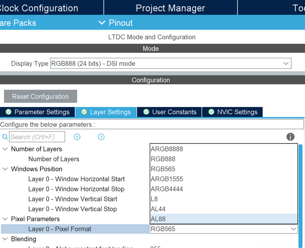

‎2022-11-29 6:44 AM
Understood!
So I design the hardware assuming RGB888 is being used, then I can switch between RGB888, 666 and 565 as needed. That's great to know! Thank you again MM :)
‎2022-11-29 7:16 AM
Yes , but this is swithed on other place, not display type.
