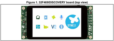

Just wanted to add that the orientation of my old project matches this:

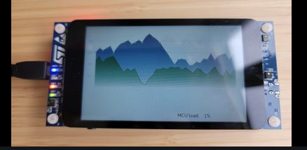

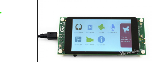

PaulK101
Here is another one that matches my previous project.
So something changed - the new project, I just created a new one and put one button w/text.  Flipped 180.
