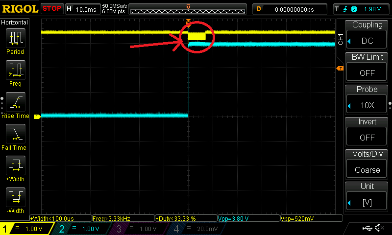

Now by running this code, the ADCs start when TickCounter gets above 500, but they stop running after ~7 milliseconds.
Here's the waveform captured on an oscilloscope.
0693W00000DqVEZQA3.pngHere the yellow waveform is the analog signal to the ADCs,
The cyan waveform is the GPIO PE4 which I used in the code above in order to find out when the ADC starts.
As you can see in the marked area in the picture, the ADC sampling starts as soon as the PE4 gets high, but instead of running until the PE4 gets low which is when the ADC suspension should occur, they just turn off after ~7ms.
The DMA interrupt priority is set to 0,0.
If anyone has any suggestions I'd be happy to hear them.
Thank you in advance

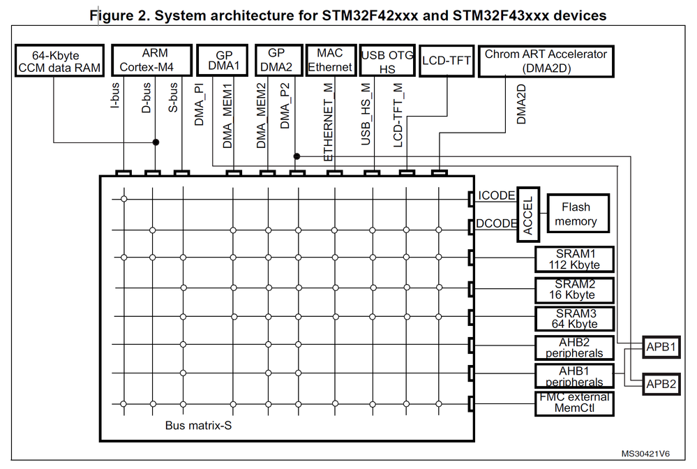

HAL_ADC_GetError just returns ErrorCode from within the handle. That's only populated by HAL if you're using its framework for handling errors.
I would examine the registers directly for an error. Although, clearly bandwidth is the issue here so I'm not sure how useful that would be.
DMA doesn't use the CPU, but it does use the system bus, along with pretty much everything else that needs to access memory. The bus is a shared resource. When it's occupied, the CPU will block until it gets what it needs. Since the ADC/DMA can't block, it overruns and will set an error flag. See the "System architecture" figure in the reference manual for a conceptual view of this.

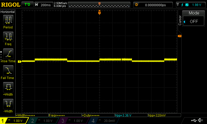

I tested the following code for the second task:
void ADCManager(void *argument)
  /* USER CODE BEGIN ADCManager */
  /* Infinite loop */
  for(;;)
	counter++;
	if (counter == 3) {
		stats = osThreadSuspend(GUI_TaskHandle);
	All_Init();
	HAL_ADC_Start(&hadc3);
	HAL_ADC_Start(&hadc2);
	HAL_ADCEx_MultiModeStart_DMA(&hadc1, (uint32_t *)ADC_Buffer, 3000);
	HAL_GPIO_WritePin(GPIOE, GPIO_PIN_4, GPIO_PIN_SET);
	osDelay(500);
	HAL_ADCEx_MultiModeStop_DMA(&hadc1);
	HAL_ADC_Stop(&hadc2);
	HAL_ADC_Stop(&hadc3);
	HAL_GPIO_WritePin(GPIOE, GPIO_PIN_4, GPIO_PIN_RESET);
	osDelay(500);
  /* USER CODE END ADCManager */
So it now suspends the TouchGFX after 3 seconds, and I can confirm that, because I blink an LED in the TouchGFX tick event, and after 3 seconds it does not blink anymore, and also the touchscreen becomes unresponsive.
But even after the 3 seconds are passed, the ADCs still stop working after 7ms!
Now, if I change the if (counter == 3) statement into if (counter == 1), which means that the TouchGFX task is suspended before it is executed even a single time, the problem solves and ADCs keep running.

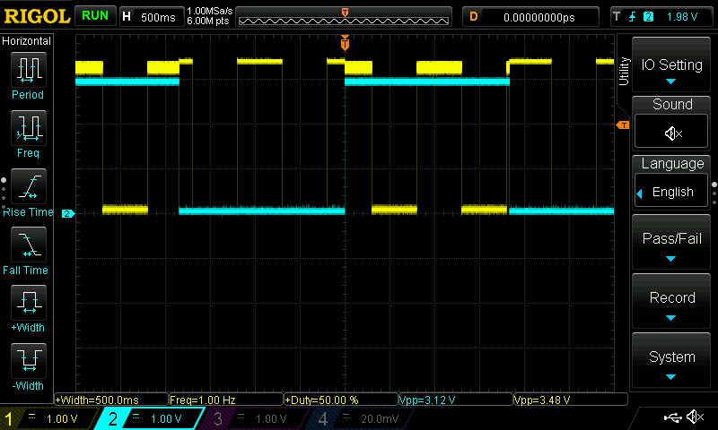

But I think I just found a solution for what I'm trying to do.
I realized that the TouchGFX is not only relying on the FreeRTOS to execute, but also LTDC interrupts (in the osWrappers).
So instead of suspending the FreeRTOS task, I had to disable the LTDC interrupts in order to keep the CPU hands off the buses.
Here's the code I tested as my second task (ADCmanager task):
  /* Infinite loop */
  for(;;)
	__HAL_LTDC_DISABLE_IT(&hltdc,LTDC_IT_LI);         //disable LTDC interrupts
	All_Init();
	osDelay(500);
	__HAL_LTDC_ENABLE_IT(&hltdc,LTDC_IT_LI);         //enable LTDC interrupts
	osDelay(500);
And here's the result:
0693W00000DlVX7QAN.pngSo as you can see, now the ADCs are running for 500ms, and are suspended for another 500ms.
While the ADCs are running, the screen & touchscreen are basically frozen, and while the ADCs are stopped, the LCD&touch are completely responsive.
