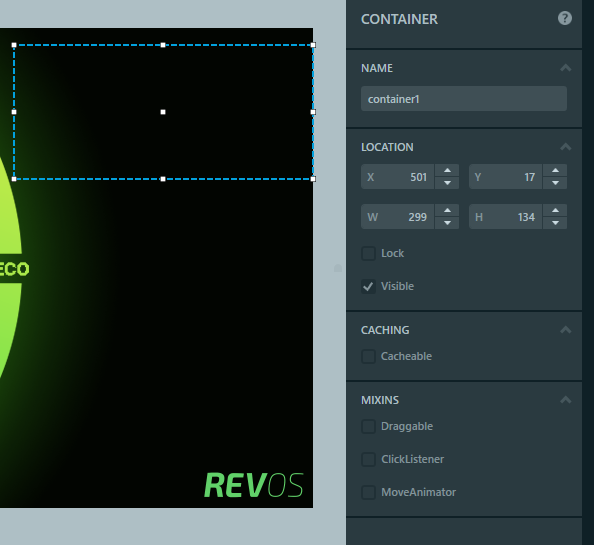

  1. Create a new empty container
  2. Position and size the container to the area in which you want the text to show. Anything outside the container will not be visible, so text will be cropped
  3. Place textArea1 inside the container, and make it a child of the container in the sidebar
  4. Use the same code above but change the start position from 800 to container1.getWidth() (obviously use the name of your actual container)
Because the X position of the text is referenced relative to it's parent (the container), the end position can stay -textArea.getWidth(). Behind the scenes, the textArea itself is much wider (and scales to wildcard size). But because it is inside a small container, and elements are not visible in areas outside their parent containers, you only see a few characters at a time.
See attached video.
Embedded UI/UX Consulting: cadenza.design
@Chandan Bhatia​ Any luck with this solution?
@Michael K​  Hi, Missed your response. I tried adding text to empty container but in touchgfx I can't find any option to make textArea1  as a child.
In the left sidebar with all the screens listed, and all the objects on the screens, just ​drag the text area item on top of the container item
