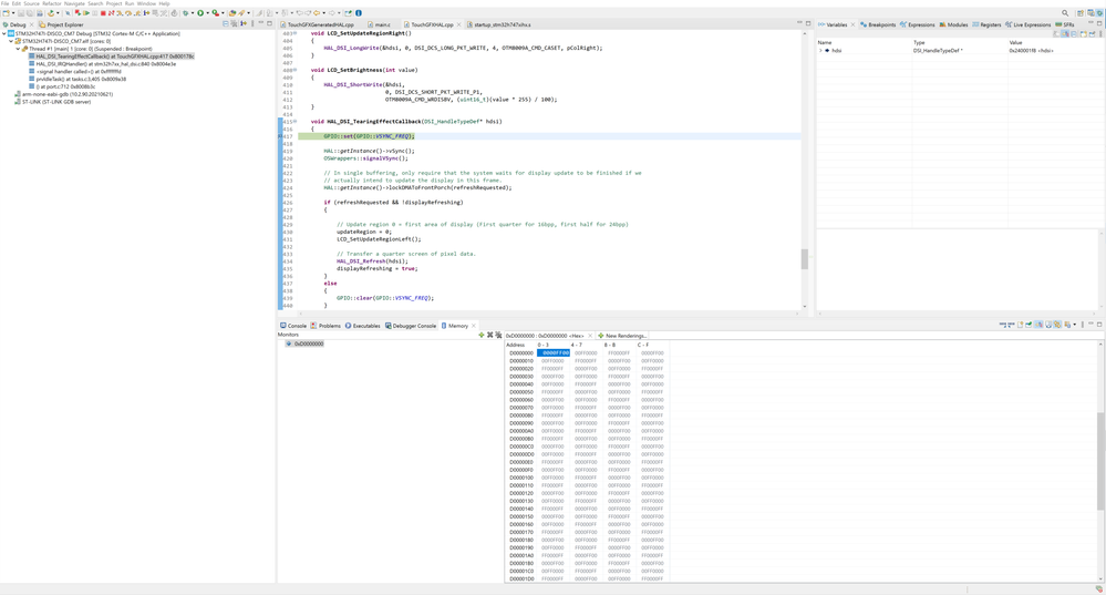

Hello @imarz.1​ ,
I tried to reproduce your error, but everything works fine for me.
Can you please follow these steps to ensure that the issue comes from your display and not from something else :
- In TouchGFXDesigner, set your background color at perfect red, like this :
- In CubeIDE, put a breakpoint in the function HAL_DSI_TearingEffectCallback() in TouchGFXHAL.cpp, click on Window>Show View>Memory, and then select your framebuffer address to see if a pixel in the first row is different from red (FF0000).
Thanks,
/Yoann

‎2022-03-24 9:34 AM
I just debugged it, and I got exactly the same numbers as yours.
Also, the demo board is brand new. I got it last week.
So, I did not really write any code. I just created two buttons in Touchgfx, and then through Cube ide I programmed it to the demo board. Everything is default.

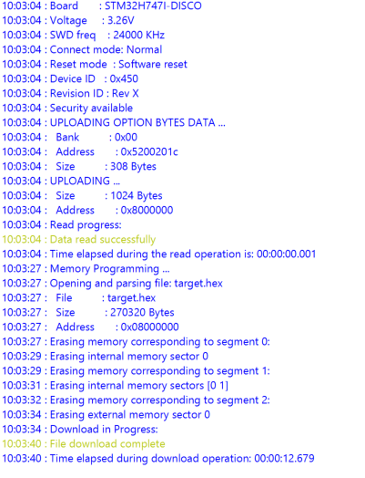

I attached text file to show the Touchgfx Designer log in both cases: First when it failed due to the path issue, then when it succeeded after I re-installed Cube programmer in different location. Remember that each programming took over 15 minutes to complete !
‎2022-03-25 2:25 AM
- For the hard coded path issue, you can change those references in the makefile of your project. Go to gcc\include\cube_programmer.mk and modify the path so they can point to your D drive. In any case, I will discuss a possible improvement in TouchGFXDesigner, to enable the user to change those paths from the Config tab.
- It is not normal at all that it takes you 15 minutes to run your application on target. When I use STM32CubeProgrammer to flash the board, it only takes me 12 seconds. Are you using the TouchGFX Board setup for your project ?
/Yoann
