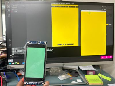

As you can see in demo touchgfx simulates same color, but after burn target color get automatic different

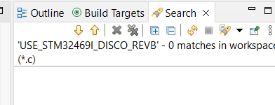

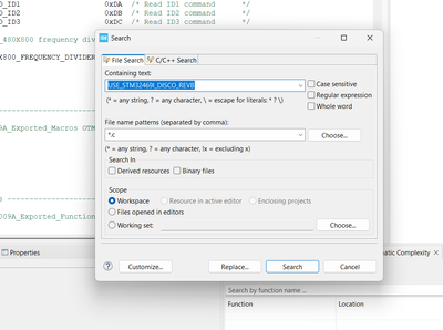

Simply this only say not in *.c files as you see on screenshot...
sorry i didn't get you. I had directlty burn target from TouchGFX

What you dont get , you search define in all *.c files, but this isnt all files. Next is *.h *.hpp *.cpp etc.
And FYI color shifting is classic trouble ond DSI with not precise horizontal porch setup corelate LTDC and DSI values.
