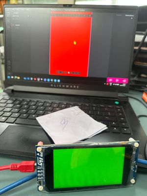

himshaAuthor
September 19, 2025
one new thing i created 2 screen using touchgfx 1st one with white back ground and 2nd on with red color. after burning code in DISCO board screen shows me green. what may be the reason?

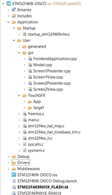

himshaAuthor
September 19, 2025
there is no such file stm32469i_discovery.h

MM..1
September 20, 2025
Exist many variants REV of boards and too in touchGFX exist versions for generated board code = many combinations and only some working ok. Read docu about diffs and primary store your code with board REV info.
And FYI in folders exist many files not showed in project tree , then better is try search or more direct search in project
USE_STM32469I_DISCO_REVB
or better read and
One of the following flags must be defined in the preprocessor
himshaAuthor
September 22, 2025
i had done direct search and got nothing

himshaAuthor
September 22, 2025
Please some one check and guide me on this. why this is happening? its very critical issue I am stuck not able to proceed further
As you can see in demo touchgfx simulates same color, but after burn target color get automatic different
