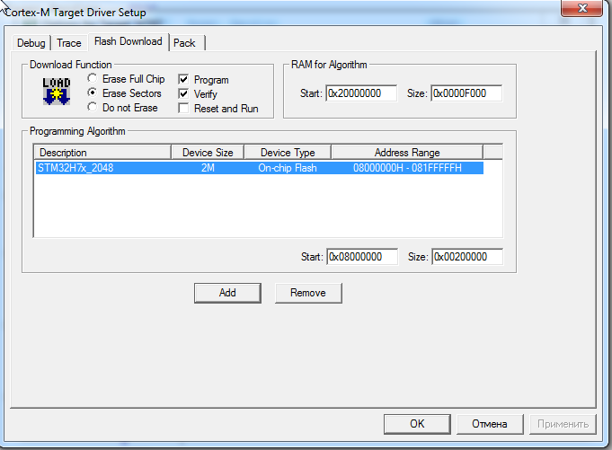

2021-02-09 10:08 AM
You'd have to have the right QSPI Flash Algorithm selected in the Debugger's Flash settings tab covering the area in question, ie 0x90000000 / 32MB
2021-02-09 10:12 AM
Hmmm...
I don't want to program qspi flash - it is already programmed.
I deleted algorithm from debugger's flash setting tab.
2021-02-09 10:13 AM
2021-02-09 10:20 AM

2021-02-09 11:37 AM
Perhaps you could make it a NOINIT section? Use objcopy post-link to remove unwanted sections?
Or perhaps uncheck "Load Application at Startup" and use a debugger script to LOAD the different sections.
In more considered systems the resource data is exported as a separate file, and the application indexes into it like a file system.
2021-02-09 11:49 AM
"Or perhaps uncheck "Load Application at Startup" "
If I do it, controller starts, but I can't control variables in watch window, can't set breakpoints....
"and use a debugger script to LOAD the different sections." - How? What I vave to write to it? For example....

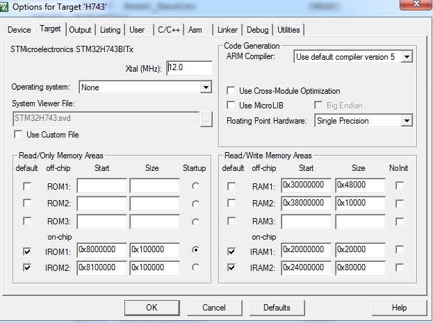

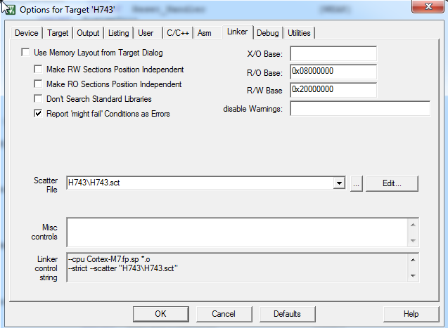

2021-02-09 11:52 AM
THis is my settings
but in linker I unchecked using of this dialog
