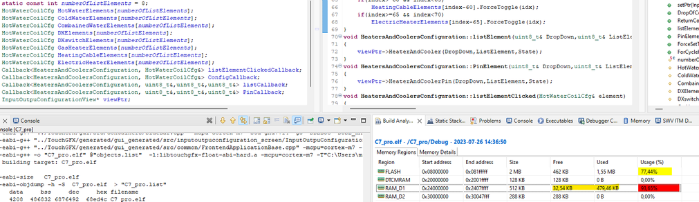

This is other example which I use in my project. I am creating 8 lists and in these lists I put elements. Each list has 5 elementslists.png

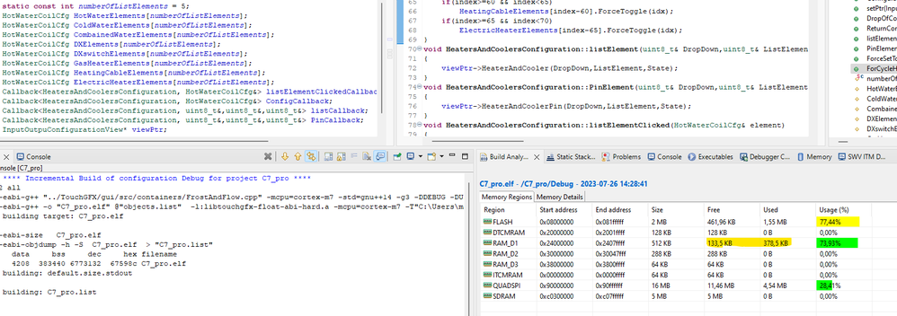

And I increase "numberOfListElements" from 5 to 8 and when RAM usage increased:
If I correctly understand it depends on how much my class HotWaterCoilCfg allocates RAM
Yes, the size of the lists depend on how big you HotWaterCoilCfg class is. However, I can see you have 5MB of SDRAM available. If you're not planning to use that part, you can put those lists inside that, although you will lose some speed because it is External Ram. But if your application is not extremely time sensitive, you can take advantage of that.
