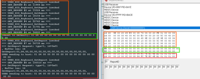

I would like to consult the USB HID GetReport feature.
The issue is that the printout data from MCU log is different from bus hound displayed result.
Bus hound is trial version, the data length indeed is 16.
This is the log I set to printout from USBD_HID_Keyboard_SetReport

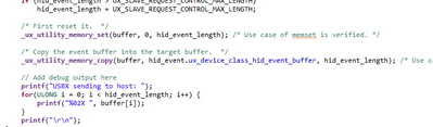

Also add the log in _ux_device_class_hid_report_get
However, in here is still show the different data from bus hound capture though it is still aligned the data in GetReport Callback.

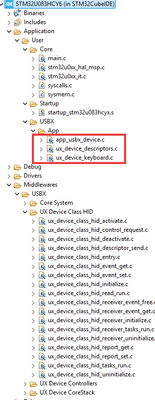

Which STM32U0 are you using? Would you attach minimum firmware to replicate the issue on a reference board?
Best regards,
FBL
CYH
Hi @FBL ,
Thank you for your reply.
I am using STM32U083C-DK as test platform but with STM32U083HCY6 pin configuration.
The minimum firmware you are saying is the source code, right?
Please kindly check the attach files as your reference.

As the image show above, I found that even I didn't set g_last_input_report for GetReport, there still have data be reported whenever host try to get report from ID 1, and the value seems could be changed randomly.
Besides that, I found that after I set the g_last_input_report which expected to be 01 D4........, though the reported data is not expected, but the value seems keep the same each time.
Not sure whether it is any hint for you to help with the analysis.

        printf("Report Data: ");
        for (UINT i = 0; i < g_last_input_report_len; i++) {
            printf("%02X ", g_last_input_report[i]);
        printf("\r\n");
        // Only log "USBX sending to host" once per report sequence
        if (current_counter != last_logged_report_counter) {
            last_logged_report_counter = current_counter;
            printf("USBX sending to host: ");
            for (UINT i = 0; i < hid_event->ux_device_class_hid_event_length; i++) {
                printf("%02X ", hid_event->ux_device_class_hid_event_buffer[i]);
            printf("\r\n");
        return UX_SUCCESS;
    printf("ERROR: Report type/id mismatch or unsupported\r\n");
    return UX_ERROR;
    /* USER CODE END USBD_HID_Keyboard_GetReport */
I have modified and add more log info inside the GetReport.
However, the data stil show different from bushound.

CYH
Hi @FBL ,
I am using STM32U083 for develpment and the library seems a little bit different from the one you shared.
My file structure is shown as below, I am not sure whether I am using legacy or custom keyborad.
I only enable the HID Core and HID Keyboard in .ioc, and modify the keyboard descriptor to the one I provided in previous message.
