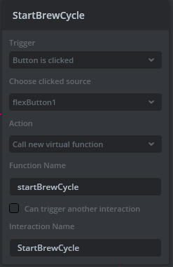

How do I trigger a new virtual function when a touch button (flexButton) is released instead of pressed?
I'm fairly new to TouchGFX as well as C++ inheritance so trying to understand how to implement a custom virtual function when a key is released. I see when I create an interaction in touchGFX so when a key is pressed it calls a virtual function...

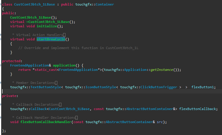

_legacyfs_online_stmicro_images_0693W00000blHmxQAE.pngWhich creates the following in the base class of the custom container...

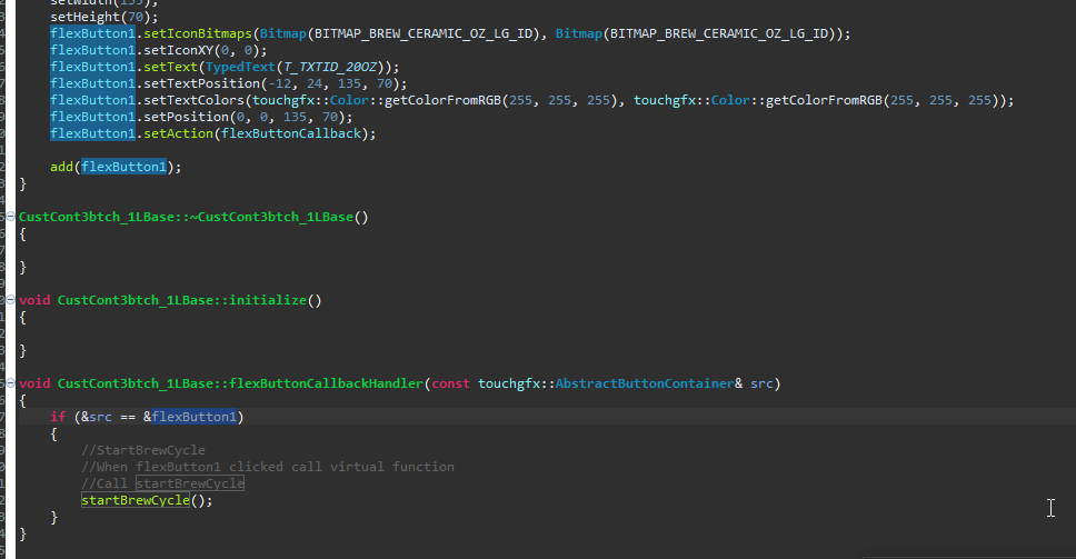

_legacyfs_online_stmicro_images_0693W00000blHiSQAU.pngI understand how to override the startBrewCycle() virtual function in the non-base cpp file which is called with the pressed even in the callback below...

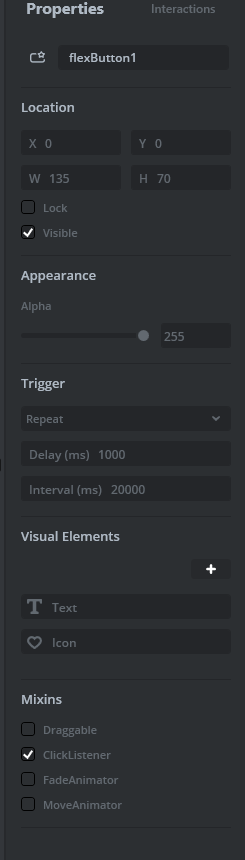

I found my old example, just modify it for flexbutton, maybe this helps. The flexButton click handler is bit more tricky than other button types. Here in the example flexbutton has just Box with border- element.
One way is to create ClickListener to the FlexButton, so set it on at Mixins of your flexButton:

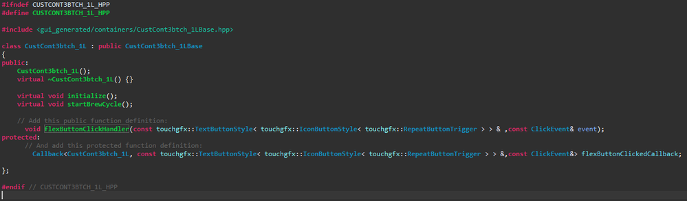

0693W00000aIb0cQAC.pngThen add the callback definitions to the screen1.hpp (or whatever you have)
class Screen1View : public Screen1ViewBase
public:
 Screen1View();
 virtual ~Screen1View() {}
 virtual void setupScreen();
 virtual void tearDownScreen();
 // Add this public function definition:
 void flexButtonClickHandler(const touchgfx::BoxWithBorderButtonStyle< touchgfx::TouchButtonTrigger > & ,const ClickEvent& e);
 // int16_t pressCount=0;
 // int16_t releaseCount=0;
protected:
 // And add this protected function definition:
 Callback<Screen1View, const touchgfx::BoxWithBorderButtonStyle< touchgfx::TouchButtonTrigger > &,const ClickEvent&> flexButtonClickedCallback;

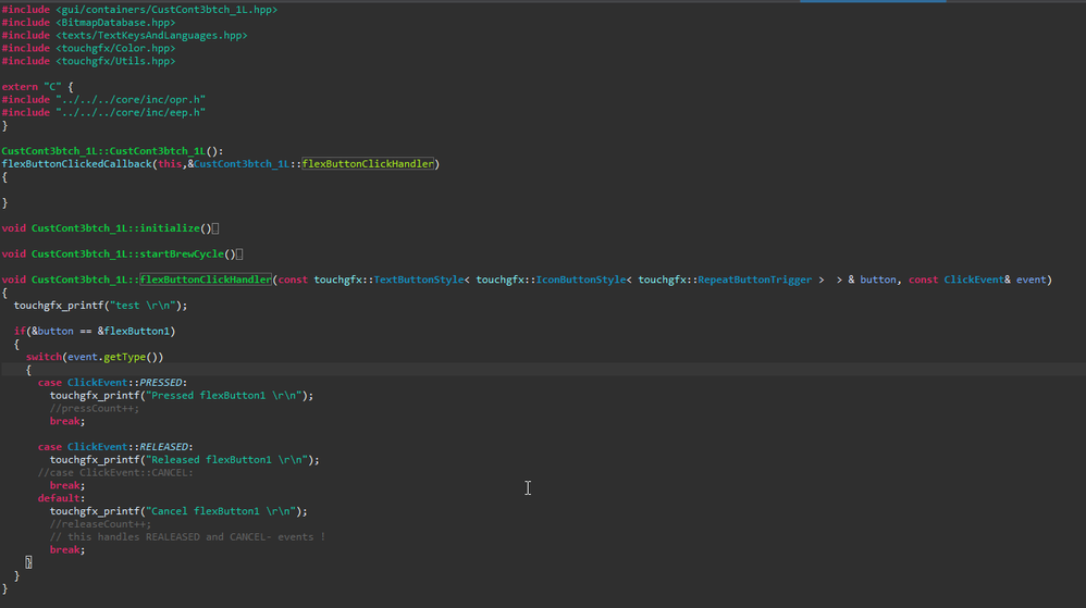

and then in screen1.cpp:
#include <gui/screen1_screen/Screen1View.hpp>
#include <touchgfx/Utils.hpp>
// Add this callback to the constructor:
Screen1View::Screen1View():
flexButtonClickedCallback(this,&Screen1View::flexButtonClickHandler)
void Screen1View::setupScreen()
 Screen1ViewBase::setupScreen();
 // This sets the click action for flexButton1 !!
 flexButton1.setClickAction(flexButtonClickedCallback);
void Screen1View::tearDownScreen()
 Screen1ViewBase::tearDownScreen();
// Add this function
void Screen1View::flexButtonClickHandler(const touchgfx::BoxWithBorderButtonStyle< touchgfx::TouchButtonTrigger >& b,const ClickEvent& e)
	if(&b==&flexButton1) // button1 -> your button name
		switch(e.getType())
			case ClickEvent::PRESSED:
				touchgfx_printf("Pressed flexButton1 \r\n");
				//pressCount++;
			break;
			//case ClickEvent::RELEASED:
			//case ClickEvent::CANCEL:
			default:
				touchgfx_printf("Released or Cancel flexButton1 \r\n");
				//releaseCount++;
				// this handles REALEASED and CANCEL- events !
			break;
//This is just debug print to display, since its tested also in device :
		//Unicode::snprintf(CounterBuffer, COUNTER_SIZE, "press:%3u release:%3u",pressCount,releaseCount);
		//Counter.invalidate();

Jul 7, 2023 4:17 AM UTC
Hello. Hmm...did you put 'setAction' - call to the 'initialize' - function ? Otherwise it looks ok with quick review.
You can also test the functionality by changing trigger to 'click' instead of repeat, i have never use click callbacks with repeat button.
Br. J.T
PFlor.2
PFlor.2Author
Senior II
Aug 9, 2023 7:45 PM UTC
Thanks JTP1...I was missing the setAction.  Totally missed you had sent a reply on 7/6.  Thanks again for the assistance!
