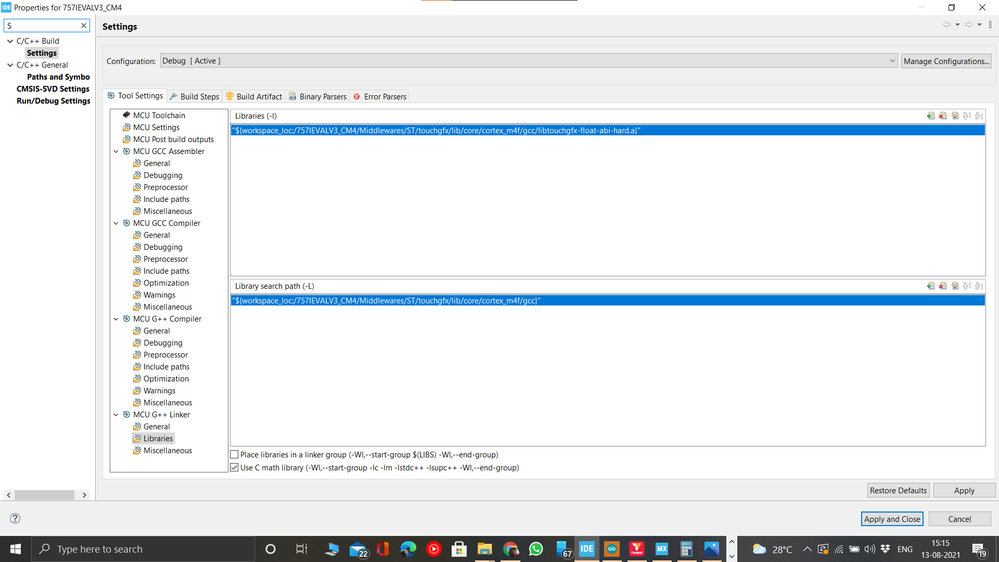

I am using Eval Board-stm32h757i and trying to interface LCD (using stm32cubeide). I have linked library and set the right path but error has not gone. Can you please help me solve this issue. 0693W00000D2P6eQAF.png0693W00000D2OziQAF.png
I think your setting is malformed for the library. You just want to reference it and let cubeide resolve it in the path that is configured. Try this.
Libraries:
:libtouchgfx-float-abi-hard.a
