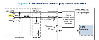

Sounds like a design issue, potentially with the power configuration. Can you upload the schematic?
Try using a lower SWD frequency. Probably won't help, but it might.
Schematic
Hmm, not real sure. Looks like you're missing this recommended 10 uF cap, but I'd be surprised if that was the issue.

I have tried adding the 10 µF capacitor, but the issue still persists.
