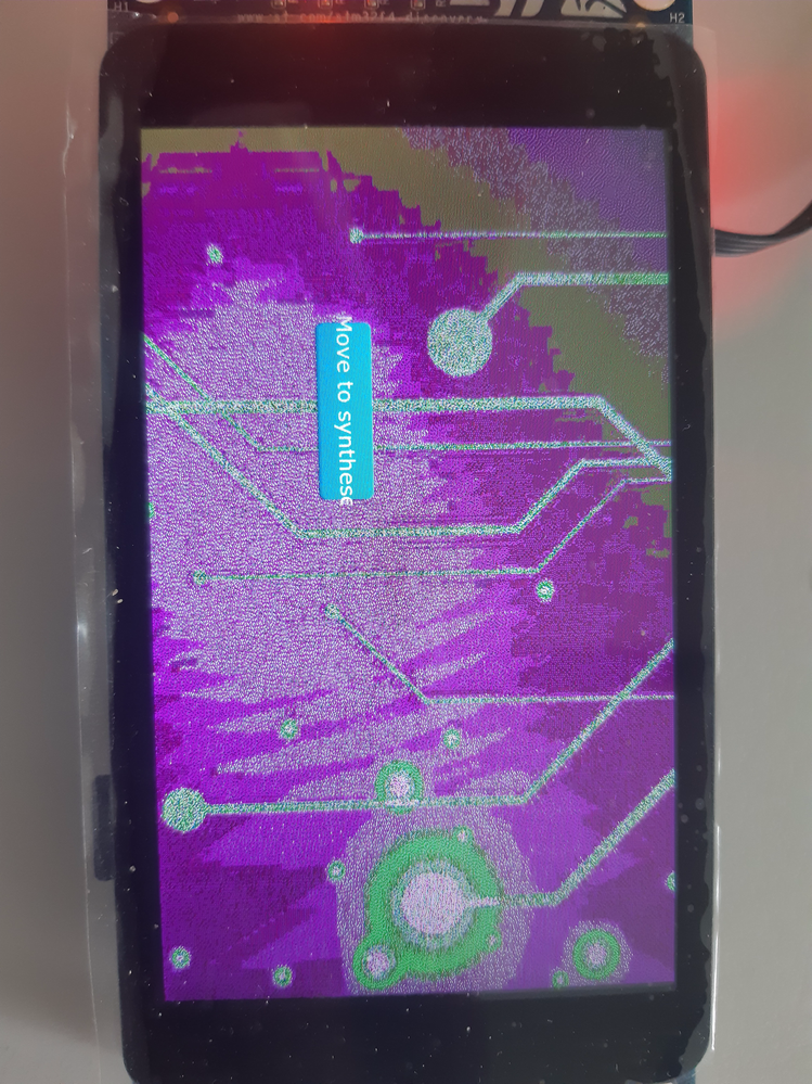

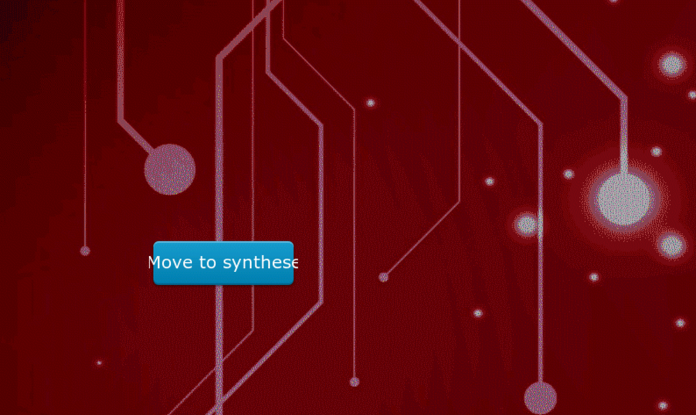

To save space on the section "ExtFlashSection" with the dev board STM32F469I-DISCO, I'm trying to use the L8_RGB565 format for my backgrounds. I'm doing this by changing the "Image Format" of all background on the "Images" section of TouchGFX Designer. This is working when I launch the Simulator but when I try actually seeing it on the board, the colors are weird like so:
Simulator:
0693W00000ANZGtQAP.pngSTM32F469I-DISCO:
0693W00000ANZHwQAP.pngHow can I solve the issue ?
Thanks in advance,
DELETRAZ Tristan

TDele.1
If possible, I wish to use both L8_RGB565 and RGB565 as I would prefere to not lose colors on some other pictures.
I've read the article you're mentioning and I did the modifications explained there over on TouchGFX Designer as well as modified the pictures with paint.net so that they have less than 256 colors.
To reproduce this issue I performed the following actions:
  • Create a new project by choosing "STM32F469I Discovery Kit" and "Blank UI"
  • On the first screen, add the wigdet "Image"
  • Add the attached image to the project's assets with TouchGFX Designer
  • Make the "Image" widget show that particular image
  • Switch that image format to "L8_RGB565" with TouchGFX Designer
  • Generate the code from the designer
  • If launched there, the image will look alright on the board
  • Instead, launch the ioc file to open CubeMX
  • Generate the code from there
  • Reload the project in the designer
  • Now if you launch the project, the image's color will now be all wrong on the board
I still have no clue on what's causing this. I've attached to this anwser the project after all those steps (you can also find the image I used in there).
Tristan

If you use a textureMapper widget instead of an Image widget the colors will be properly displayed. I will further investigate but my first guess is that this could be related to the DMA2D and ChromART. I know there has been a lot of work in the coming version 4.17 to stabilise ChromART to fix this kind of bugs.
For now I can recommend to use textureMapper widgets for the L8 images if relevant in your project.
/Romain
Ok so I just tried disabling ChromART in STM32CubeMX and the L8 images are properly displayed even when using an Image widget.
So either use TextureMapper widgets or disable ChromART (which will lower the performances, but this could be acceptable depending on what you aim to do)
/Romain
