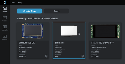

Hello @Kshingala ,
Since you want to separate the designing part from the rest, it seems that the best solution would be to ask the "design team" to create a GUI from a blank canvas not assigned to a board (instead assigned to a simulator) :

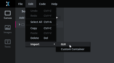

Then, the rest of them team (the one flashing on the device) can import the GUI designed by the design team :
This way, the design team can modify the GUI as much as they want and then the flashing team can update the project with the changes.
There is no way to flash 2 different binaries as far as I know.
