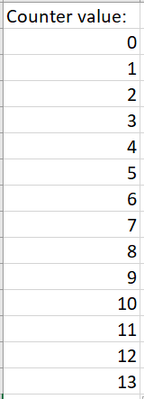

I have been trying to display continuous data on Scroll wheel container for the past 2 months but have been very unsuccessful. Could someone help or tell me if it's even possible to do that?? The example in the documentation does not help in that regard.
I would like to display a counter that goes from 0 to 255 on a scroll wheel but what I get is the exact same value on each row of the scroll updating in real time. What I want is each counter value displayed on each row, e.g
