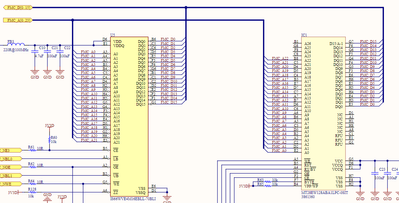

I have external PSRAM IS66WVE4M16EBLL + NOR MT28EW128ABA1LPC-0SIT with STM32H753ZIT6. They are both on the same bus:
FMC: NOR 0x60000000,PSRAM 0x68000000. Not using MPU. I use raw addresses of PSRAM as memory mapped, and HAL functions to transfer data to NOR. I tested memory integrity, R/W - all fine.

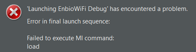

I triend many addresses to try fit at least 500k of graphics and it always fails during uploading with Failed to execute MI command load.
All caching logic is working fine. I only need to understand how to treat addresses managed by linker. Could you give me a hint?

It seems linker script attribute UNLOAD is required. Adresses are generated becouse in output binary information about graphics data is preserved. But they will not populate selected memory region's section. So variables will have some invalid pointers which can be then mapped to external memory. So IMO in the example of TouchGFX it will be better to have:
ExtFlashSection(UNLOAD) :
*(ExtFlashSection ExtFlashSection.*)
} >USB
But I'm not sure, I'm not linker expert :)

@sss343  Yup exacly. It is all working fine now :)
Firstly I uploaded code with (UNLOAD) attribute to target. Then without (UNLOAD) I extracted graphics data from .elf file as in the article
arm-none-eabi-objcopy --dump-section ExtFlashSection=images.bin ../Debug/HMI.elf
Then function to cache NOR FLASH to PSRAM with use of transfer buffer in internal RAM. Transfering 1.5M takes not much time at starting of the device. About 1 sec. 8M PSRAM is sufficient to store all the graphics.
