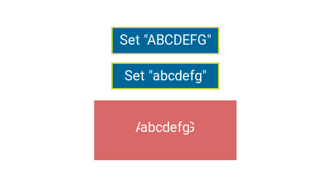

A TextArea with one wildcard is used to display a value centered in its field. When a larger value is overwritten with a smaller value, the new value is centered in the TextArea, but a “residue�? of the previous, larger value, remains visible on both sides.

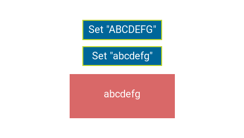

A Case in Point
We have 2 strings of the same length. Initially the TextArea (one wildcard) in the red box contains “ABCDEFG�?, all caps. When we click the bottom button to execute the following code:
touchgfx::Unicode::snprintf(textAreaBuffer, TEXTAREA_SIZE, "abcdefg");
textAreaBuffer[TEXTAREA_SIZE-1] = 0;     // ensure string termination
textArea.resizeToCurrentTextWithAlignment();
textArea.invalidate();
0693W00000Uo7vYQAR.pngThis is the problem outlined in the initial forum post.
When, as suggested, we change the resize/invalidate order:
We get the desired result:
0693W00000Uo7vdQAB.pngCoding for Both Cases
