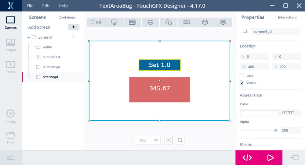

Simple Screen
The project includes a single screen with a white background, and three additional objects:
  • A blue Flex Button (setBtn), labeled “Set 1.0�?
  • A single-wildcard TextArea (numberText( with initial setting “345.67�?
  • A red Box background (numberBgd) to the TextArea.
Screen Appearance

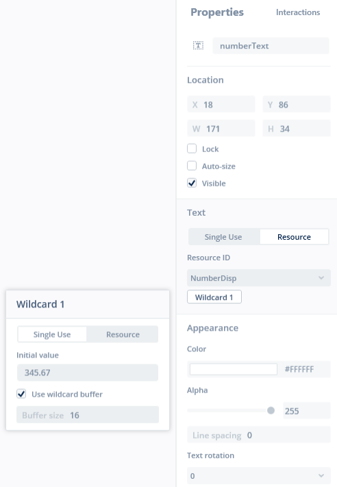

The TextArea (numberText) is of fixed width, non-autosize, includes a buffer with a 16 character size. and has an initial setting og 345.67:

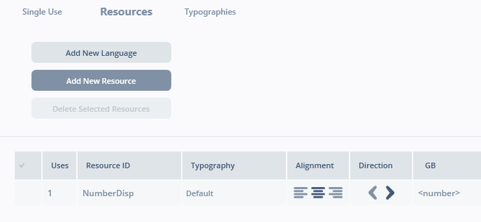

The text resource (numberDisp) specifies the default font, centered display, and single wildcard (<>):

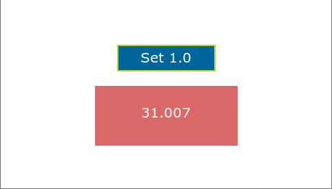

0693W00000UnfbQQAR.pngScenario 1: Text Replacement Error
In the first attempt, the following code places the number “1.00�? into the text buffer associated with TextArea numberText:
    touchgfx::Unicode::snprintfFloat(numberTextBuffer, NUMBERTEXT_SIZE, "%.2f", 1.0f);
    numberTextBuffer[NUMBERTEXT_SIZE-1] = 0;     // ensure string termination
    numberText.resizeToCurrentTextWithAlignment();
    numberText.invalidate();
One would expect that numberText would now display “1.0�? against its red background. But, instead, the following screen is displayed:
0693W00000UnfbVQAR.pngIt goes without saying that this reading, interpreted as valid by factory personnel, might result in a seriously incorrect response, or even dangerous actions. So, this display error demands careful examination to determine the cause.

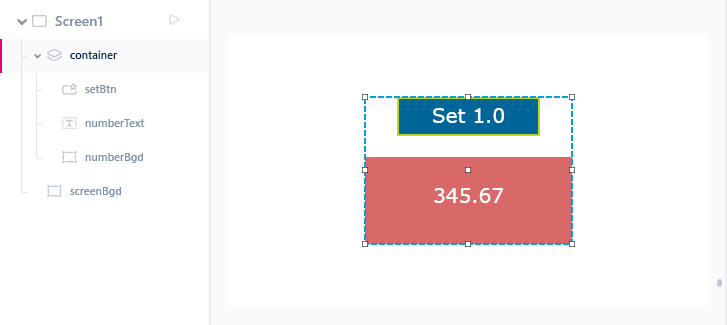

But now, in order to make reorganization of the screen easier, we decide to place the screen objects inside a simple container:
0693W00000UnfbzQAB.pngAnd then, use the same code as before to update the display:

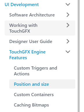

As it turns out, in my post, I failed to include the fact that we're operating in version 4.17 of TGFX---the version is fixed by my client's policy during phase 1 of the development effort. And, in fact, the documentation reference you provide, which clearly explains the issue here, was not present in 4.17 documentation, at lease not in the place it occupies in the 4.20 document ("Position and Size"), and not anywhere that I could locate by searching in 4.17:
4.20 Documentation
4.17 Documentation
So, finally, all's well that ends well. And, when my current client or a future client selects 4.20 (or whatever then is the current version), I promise once again to go over the docs to make sure I'm aware of all the new information and nuance that has been added.
