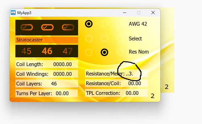

Hi all. I'm having trouble with the following function. My TouchGFX gui
has two radio button groups, each with three radio buttons.
The first selects between three different wire gauges, awg42, awg43 and awg44.
The second set selects between the resistance values of each of the wire gauges.
For each wire gauge, I have three resistance values, min, nom and max to
account for variance in the actual wire resistance in a real-world situation.
Obviously, resistance is based on a variety of external factors.
I have a single TextArea on the screen to which I want to print the decimal
value of the selected resistance.
So for example, I want to select a wire gauge of awg42 with a nominal resistance value
or, select a wire gauge of awg43 with a minimal resistance value and have the screen
update with the result.
So far, this is not happening. The TextArea is updated with the format specifier, not
the resistance value. I have tried snprintf alternatives but without success.
I'm using a typedef struct to hold all the resistance values for reasons of clarity.

void MainView::awgParameters()
float wire_res = res.zero_000;
if (awg_btn_grp.getSelectedRadioButton() == &awg42_btn)
if (res_btn_grp.getSelectedRadioButton() == &resMin_btn)
wire_res = res.awg42_min;
else if (res_btn_grp.getSelectedRadioButton() == &resNom_btn)
wire_res = res.awg42_nom;
else if (res_btn_grp.getSelectedRadioButton() == &resMax_btn)
wire_res = res.awg42_max;
else if (awg_btn_grp.getSelectedRadioButton() == &awg43_btn)
wire_res = res.awg43_min;
wire_res = res.awg43_nom;
wire_res = res.awg43_max;
else if (awg_btn_grp.getSelectedRadioButton() == &awg44_btn)
wire_res = res.awg44_min;
wire_res = res.awg44_nom;
wire_res = res.awg44_max;
//Unicode::snprintfFloat(wire_res_valueBuffer, WIRE_RES_VALUE_SIZE, "%.3f", wire_res_val);
//Unicode::snprintfFloat(wire_res_valueBuffer, sizeof(wire_res_valueBuffer), "%.3f", wire_res_val);
Unicode::snprintf(wire_res_valueBuffer, 15, "%.3f", wire_res);
wire_res_value.invalidate();

2024-12-29 8:07 AM
Perhaps it's a limitation of the snprintf() here in this context.
Can you also print to a terminal/debug channel here to confirm what exactly is choking.
Perhaps you could stage in a string via ftoa() dtoa() type construct?
How is the Coil Length/Windings code constructed?
2024-12-29 10:57 AM

2024-12-30 2:18 AM - edited 2024-12-30 2:21 AM
@Tesla DeLorean Hi.
Apologies, I thought you were asking re. the construction of other working functions in my code.
Yes, it appears to be properly and fully initialized in MainViewBase and, to the best of my knowledge is correctly set up in MainView also.
in MainViewBase.cpp
wire_res_value.setPosition(130, 3, 60, 20);
wire_res_value.setColor(touchgfx::Color::getColorFromRGB(0, 0, 0));
wire_res_value.setLinespacing(0);
Unicode::snprintf(wire_res_valueBuffer, WIRE_RES_VALUE_SIZE, "%s", touchgfx::TypedText(T___SINGLEUSE_I9YL).getText());
wire_res_value.setWildcard(wire_res_valueBuffer);
wire_res_value.setTypedText(touchgfx::TypedText(T_DATA_8));
wire_res_container.add(wire_res_value);
and in MainViewBase.hpp
static const uint16_t WIRE_RES_VALUE_SIZE = 10;
touchgfx::Unicode::UnicodeChar wire_res_valueBuffer[WIRE_RES_VALUE_SIZE];
touchgfx::TextAreaWithOneWildcard wire_res_value;
I can declare an arbitrary floating point value to the 'wire_res' variable and it will print the result to 'wire_res_value' on the screen providing, that is, I bypass the nested if/else if statement by commenting out the entire block of code.
This leads me to believe that I have an issue with the RadioButtonGroup implementation in that the 'getSelectedRadioButton()' calls are not finding the associated radioButtons (I may be wrong, I usually am)?
I'm going to spend some time with printf output to console today and see if it bears any fruit. Thanks again for your time.

@GaetanGodart Hi.
Also, it seems to print "..3." but what is the value expected.
The value "..3." is the value of the format specifier as a result of the
incorrect snprintf function. The values I expect are contained in the
typedef struct WireResPerKm. These should be called from the
awgParameters() function if/else if implementation:

typedef struct {
//... other definitions
float awg43_min;
float awg42_max;
float awg42_nom;
float awg42_min;
} WireResPerKm;
@Tesla DeLorean and @GaetanGodart
As expected, stripping out the existing if / else if code, the value assigned to the variable wire_res is printed correctly to wire_res_value TextArea:
// works as expected by omitting else/else if code from the function body.
// The value of wire_res is printed to the 'wire_res_value' TextArea
float wire_res = res.awg42_max;
// or float wire_res = 5.91f;
Unicode::snprintfFloat(wire_res_valueBuffer, WIRE_RES_VALUE_SIZE, "%.3f", wire_res);
With the if / else if code present, the wire_res value is ignored and nothing is printed to the TextArea:
//float wire_res = res.zero_000;
float wire_res = 5.125f;
// this function code does not produce a result. The value
// of 'wire_res' variable is not being printed to the 'wire_res_value' TextArea
// function code end
Thanks
