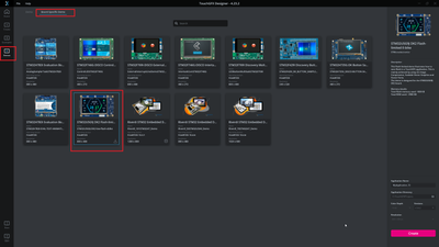

‎2024-05-31 2:30 AM
Hello @amb ,

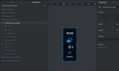

You can find an example of cacheable custom container in the board specific demo of the STM32U5G9 : the Ebike demo.
This is how we turn a custom container to cacheable :
When cached, it is turned into a bitmap.
From there you can load that bitmap as data for your texture mapper.

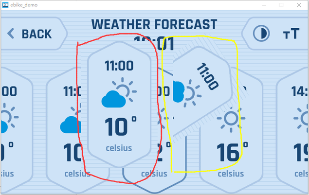

‎2024-05-31 4:45 AM
hello @GaetanGodart
I have tried the demo and found the cacheable container indeed can be used as a source of textureMapper .
the red part is a image widget,the yellow part is a textureMapper widget with 1 rad rotate .The image source is dynamicBitmaps[1].
this really makes my project a lot easier.
