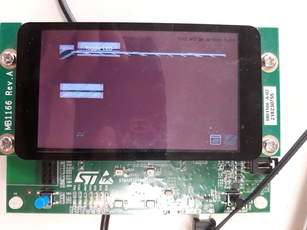

Here is how my widgets are currently rendered on my ST32F769I-discovery board. I know the problem is related to the external flash because the only image saved in the internal flash is displayed properly but I don't know exactly where the problem stems from and which parameters I've got to modify to make everything looks right.
Thanks for your help.

Hi, I had a similar problem on the STM746 Discovery board. What I remember is that the was that the images in external flash needed to be re-programmed every time they you change them (Usinf the st-flash tool and setting up its driver to access the external flash. Driver was built into the tool you just had to select the correct one). Development environments generally only know about the processor and its internal flash. External flashes mostly have to be programmed separately
Can't remember the exact details but there was a tutorial on ToughGFX website.
I remember my work flow was something like this:
Create project with initial screen layout etc as you have done
Generate the binary
Use st-flash tool to program the binary
Then start debugging (if the touch GFX part stays constant then reprogramming external flash was not necessary )
If GUI changes then external flash need s to be reporogrammed.
Hope This helps

This also can happen when working with different screen orientations. There are a number of changes you must make in order for everything to work right on the designer, simulator and target device and if you miss a step the image assets will look like this. Based on your picture though it doesn't appear to be orientation related.

Here is the procedure that I mention in my previous post regarding Internal and external flash
https://touchgfx.zendesk.com/hc/en-us/articles/205264831-How-do-I-program-STM32-based-boards-using-ST-Link-utility-
As mentioned above, this worked for me.

Apologies for my tardy answer but the issue is related to IAR workbench that can't flash the external memory. Doing as presented by Graeme works just fine.

Just to give you some history on this:
In the before time we tried to have flashloaders for all supported compilers: IAR, Keil, gcc (ST-Link). If we couldn't find them, we'd sometimes write them ourselves.
Now that TouchGFX is owned by ST none, or at least very few, of our projects have flashloaders built in. ST-Link or STCubeProgrammer are the tools to use, but it can be an easy thing to forget to reprogram image assets, etc.
