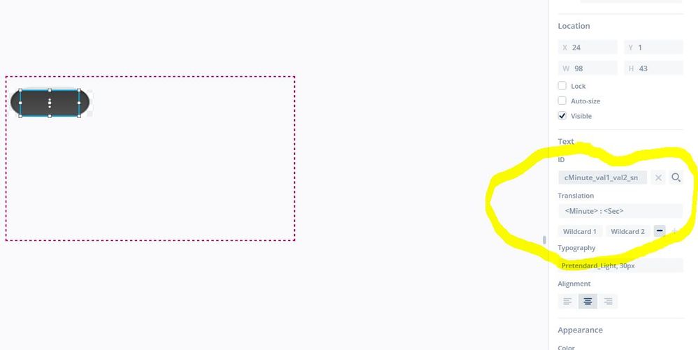

I want to know how to use "Wildcard" in "Text Area" of container.
Container is created as shown in the figure below.
We are going to use Text Area and WildCard for Container.
I'm trying to change the WildCard data by calling the Container created above in "Screens", but I don't know how.
The tutorial in the link below is only briefly shown.
-> https://support.touchgfx.com/4.20/docs/development/ui-development/ui-components/containers/container​
I want to edit Wildcard in TextArea of ​​Container in Screens with "snprintf" as shown below.
Unicode::snprintf(customContainer_Name.textArea_Name.textArea_kBuffer, customContainer_Name.textArea_hiddCook.TEXTAREA__SIZE, "%02d", (int)( data ));

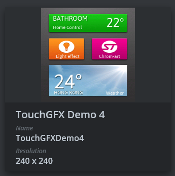

You could have a look at TouchGFX Demo 4, see picture below. There are some containers with changing values.
