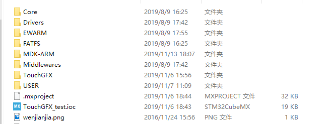

Here is the app.mk.
# Location of the TouchGFX Environment
touchgfx_env := G:/TouchGFX/4.12.3/env
text_converter_options := remap A4 BPP24 binary_fonts
Here is my project. In this project , I can not create the binary_fonts with using the TouchGFX designer 4.12.3.
