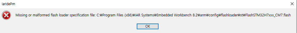

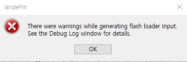

To check application template, i made simple project from TouchGFX Designer, and i pressed Generate code button.
i found functions that you said.
and i press button 'make'
there is errer -
so because of these errers, when i flash program, should i use ST-Link Utility?
AND i cannot understand how to integerate two project.
To integrate two projects, should i transfer files from project files that made from Cubemx to project files from TouchGFX Designer?
Martin KJELDSEN
Chief III
None (except maybe a few) of our projects have external flashloaders configured for IAR or Keil projects. It is only the target/Makefile that has the exact flash name embedded inside which it uses with ST-Link/CubeProgrammer to program a board.
