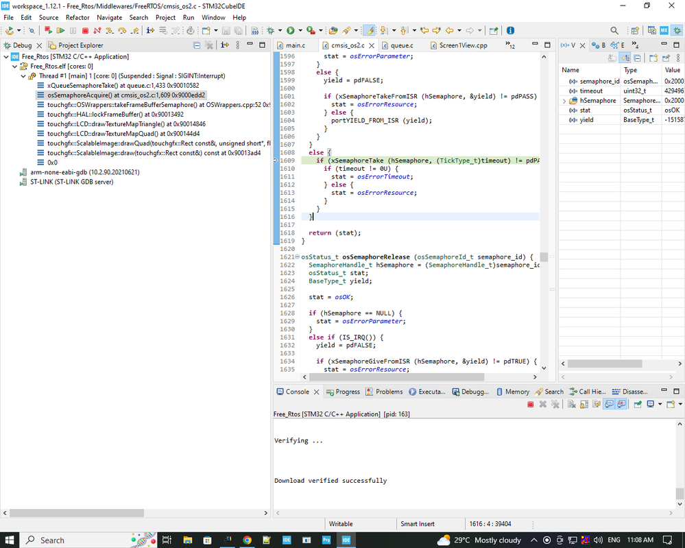

I am currently working on the STM32H750VB custom board where 16 bpp RGB LCD Interface is used. After sending the data for couple of times successfully on the LCD screen, it stops displaying the data. On debugging, I found out that it gets stuck on configASSERT( pxQueue->uxItemSize == 0 ) called from xQueueSemaphoreTake().

I tried what you said without using '*' but it didn't work the problem remains the same.
I send you the flow of it I hope it will help you to understand the problem.

I tried commenting out  the queues messages and  check it using debug the problem remains the same and please check the Semaphore once .I send you my project again.
