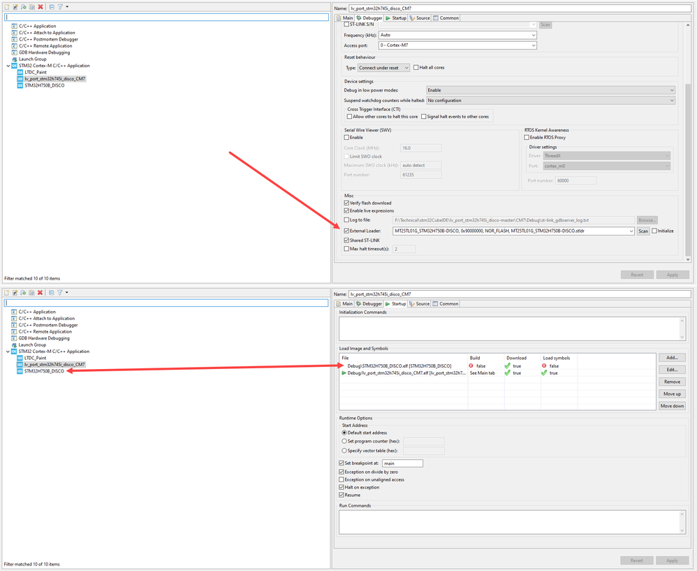

I am trying to get the https://github.com/lvgl/lv_port_stm32h745i_disco to run on the STM32H750 instead of the H745 disco.
I have selected the external loader and at startup the corresponding project loader. In the main.c file of the disco port project I have removed the QSPI inits.
I replaced the linker script file with the content from the linker script of LTDC_Paint example for the STM32H750.
It compiles and flashes everything without errors, but nothing works, also no LED starts.
What else do I have to adjust or should I consider?

pk84
Senior
see screenshot below of my setup.
the lv_port_stm32h745.. project is loaded on the external QSPI flash (with external loader), so of course it does not need any QSPI init.
In the internal flash I load the STM32H750B_DISCO project, which is the program that makes the QSPI init + jump to the main program on the QSPI.
This internal flash program I already tested with another project (LTDC_Paint) and it works fine...
So that with the QSPI, external loader I should have considered, have I forgotten anything else?
I have no error, but even though nothing happens, no LED blinking, nothing...

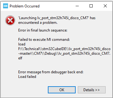

But maybe something is wrong in the lv_port project, so I tried to load this project first to the internal (128kB) flash and test it.
I have commented out as much as possible and only added a LED blink function.
Unfortunately I get the following error message when loading.

pk84
Senior
ok, I forgot to change to internal flash in the ld-script, because of that I got the Error above.
