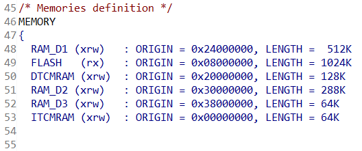

Thanks @MM..1​. Actually, I am confused about linker script. Here is my memory adress definitions. I don't know which one is STM32H757XI's internal RAM. How can I learn?
I am aware of fmcinit2 is not a good step, just trying to understand if the internal RAM is used or not. 0693W00000WIeCVQA1.png
All RAM on image is internal . Learn you can in datasheets and reference manuals for H7.
For simply example more RAMs is here for in paralel use DMA,CPU,cores, independent bus ... But this need be managed in linker sections over your ...
