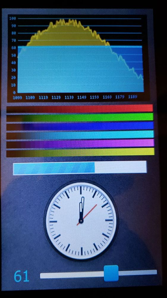

Here is my test: the first graph (yellow) is sine with random noise and second one (blue) is slider value (61)
 dynamicGraph1.addGraphElement(dynamicGraph1Line1);
  dynamicGraph1.addGraphElement(dynamicGraph1Line2);

dynamicGraph1 in your code is a line. You need another line object with different data:
MainView: : handleTickEvent ()
dynamicGraph1.addDataPoint( Value1 );
dynamicGraph2.addDataPoint( Value1+10 );
This way you will have two parallel lines with 10 points distance

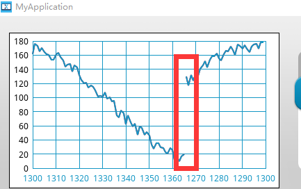

Another question, how to adjust the red area of line, hoping to leave some space between the old data and the new data

Your picture is a SINGLE graph line. This is a method of drawing large amount of data points when new data is overwrites old one in a circular buffer.
Take a note of X axis labels: 1270-1300 is an old data being replaced by new one (1300-1360)

Yes, how do I make Xnew = (Xold+100), keep the gap equal to 100
