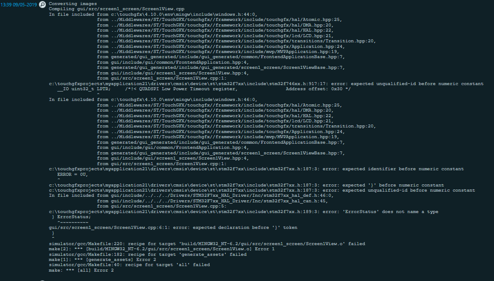

Hello, I am new to TouchGFX. I am developping an UI forSTM32F746G-DISCOVERY board. The goal of my UI is that the user can choose some value of variables and then send it to an other device using CAN bus. All the graphical part is working well, I use three screens and model to acces the variables from all the screens.
However, when I want to use the CAN, I face some issues. CAN driver have been made by my teamworker. I wanted to include the CAN driver file to the Model.cpp but I have includes errors. So I tried to include the stm32f7xx_hal_can.h provided by the project but it doesn't work.
Any idea for including the CAN driver? Maybe I should not include it in the main.cpp.

Compilation error message:
Converting images
Compiling gui/src/model/Model.cpp
In file included from gui/src/model/../../../../Drivers/STM32F7xx_HAL_Driver/Inc/stm32f7xx_hal_can.h:45:0,
from gui/src/model/Model.cpp:3:
gui/src/model/../../../../Drivers/STM32F7xx_HAL_Driver/Inc/stm32f7xx_hal_def.h:46:23: fatal error: stm32f7xx.h: No such file or directory
#include "stm32f7xx.h"
compilation terminated.
simulator/gcc/Makefile:220: recipe for target 'build/MINGW32_NT-6.2/gui/src/model/Model.o' failed
make[2]: *** [build/MINGW32_NT-6.2/gui/src/model/Model.o] Error 1
simulator/gcc/Makefile:182: recipe for target 'generate_assets' failed
make[1]: *** [generate_assets] Error 2
simulator/gcc/Makefile:40: recipe for target 'all' failed
make: *** [all] Error 2

Looks like you're missing an include path in your Makefile.
Generally, i'd advise for handling CAN communication in a seperate OS task and then using a message queue to communicate with the GUI Task (in Model::tick() ). But if you just want to get it working, doing the work in the GUI task is okay for now - Any time spend handling communication will take away from your frame render time.

‎2019-04-11 12:45 AM
You can add your include paths to line 170.
include_paths := $(library_includes) $(foreach comp, $(all_components), $(comp)/include) $(framework_includes) $(source_Middlewares_paths) my/include/path
Your include path is relative to the root of the application.
Hope that helps.

‎2019-04-11 4:42 AM
Hello Martin,
I watched the webinar and it gave me useful informations. I decides to keep it very simple by creating a new project and trying to include the HAL_can driver. I could not get it working . So I
-created a new project
-added the include line in the model.cpp
extern "C" {
#include "../../../../Drivers/STM32F7xx_HAL_Driver/Inc/stm32f7xx_hal_can.h"
-added include paths to the makefile :
include_paths := $(library_includes) $(foreach comp, $(all_components), $(comp)/include) $(framework_includes) ../Drivers/CMSIS/Device/ST/STM32F7xx/Include ../Drivers/CMSIS/Device/ST/STM32F7xx/Include ../Drivers/CMSIS/Include
This compilation is made for simulation mode and not working. When I try it in run target mode it works without makefile modification. Do you thinks it has to do with the fact that hal_can_library is not supported by simulator? Since it seems to be working with my discovery board, I can continue with my project.

‎2019-05-09 5:44 AM
Hi Martin, I still have the same issue for including the stm32f7xx_hal_can.h library to my Touchgfx Project. I have tried to manually edit the paths of the include and I could get some progress in the includes. However, at one point I have this issue
I also tried to add an include path in the mainfile: include_paths := $(library_includes) $(foreach comp, $(all_components), $(comp)/include) $(framework_includes) Drivers/CMSIS/Device/ST/STM32F7xx/Include
but I still have that error:
Maybe it has to do that the HAL CAN library is not supposed to work with the simulator?
‎2019-05-10 12:54 AM
Hi @FFont.18​,
Oh, yes, definitely! You are correct. The simulator makefile is very different.
If you have any target specific code in your project please sorround it with the following to prevent it being compiled for the simulator.
#ifndef SIMULATOR
#endif
‎2019-05-13 5:49 AM
Thank you very much I could include my library.
