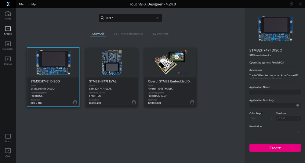

Dear Sir,
My  STM32H747I DISO board's LCD is MB1166-A09 , it's driver is nt35510. When I use "STM32H747I DISO board" to create new project, the lcd driver is otm8009a. May I change the default driver to nt35510 ?
Thanks.

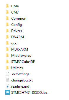

August 30, 2024
When you create a STM32H747I-Disco project from TouchGFX designer, you will have a project directory structure as below. Navigating through CM7->Core you can find main.c inside Src and main.h in Inc. Please, study the code and how the display driver is used before replacing it with nt35510.
STM32H747I-Disco TouchGFX Board SetupSTM32H747I-Disco TouchGFX Board Setup
Project Directory StructureProject Directory Structure
