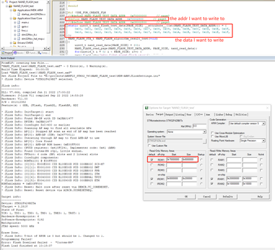

As I said above, I want to write data to Nand Flash extended by FMC by MDK directly.
After reading(LAT1198), I know an algorithm for Flash can program the data to extFlash by MDK.
I followed the steps one by one:
1. I created a project by cubeMx that can read and write the NAND flash normally by MDK;
2. I copy the template in the "ARM\Flash" folder and port the NAND flash driver to the template, it builds with no error and generates the FLM file, the code as below;

3. I tested the FLM file, but the download always failed.
I don't know what details I missed led me to fail.
Could you help me, thank you!
On Keil the scatter file (.SCT) would drive the data placement. Check the sections via the .MAP output from the linker, or a dump of the .AXF via FROMELF tool
Is the FMC/NAND on the F429 at 0x70000000 ? Or one of the four 0x60000000 banks?
The .FLM needs to actually work, what part of the download process fails?

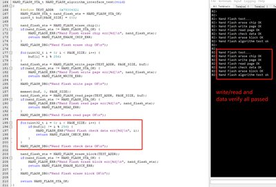

Do you have the NAND writable from a regular application? Perhaps you can build a test app that can write .HEX data into NAND, either by decoding a stream of data, or perhaps a .BIN you can feed with X/Y-MODEM. Prove you can get data successfully into the NAND, and validate the data on PC vs STM32 with perhaps checksums or CRC.
Thanks @Tesla DeLorean
I already checked the map file and the data at 0x70000000.
I also tested the interfaces that are used in FlashPrg.c, seems all the interfaces are passed:
I am helpless because I already tried all the things in my mind.
I want to debug it, but I don't know how.
Do you have any other ideas to check what I am wrong, thanks a lot.

Thanks GOD, I find the way at last.
The key point is we can NOT use interrupt in the FLM file, so we must rewrite the HAL_GetTick() function:
HAL_StatusTypeDef HAL_InitTick(uint32_t TickPriority)
  return HAL_OK;
uint32_t HAL_GetTick(void)
  static uint32_t ticks = 0U;
  uint32_t i;
  for(i = (SystemCoreClock >> 14U); i > 0U; i--)
    __NOP(); __NOP(); __NOP(); __NOP(); __NOP(); __NOP();
  ticks += 1;
  return ticks;
The following is the test code and the link file .sct:
