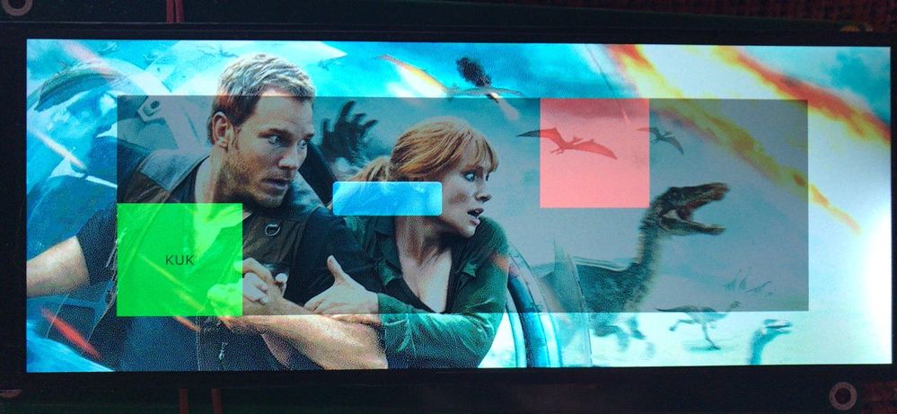

0693W00000AMRWmQAP.jpgAt 1 example 2 layer custom alpha used TGFX manage inner rect. I dont have MCU with keying feature, but setup keying can here maybe setup rounded rect or other effects as no full rect alpha ...
