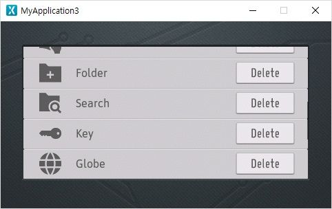

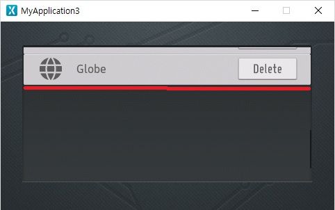

I am creating my menu using ListLayout Example of TouchGFX example code.
I want to set the Limit of the Scrollbar. But when I reviewed the current example and Class, I could not find that part.
How can I set Limit ?????
The end of the current list is similar to the one below, but I want to make the end of the list like the second one.
1st.
2nd.

same problem here :)
2019-05-06 6:16 AM
Its like the scrolling limit value is somehow set to the upper side of the container instead of the lower side
2019-05-07 4:00 AM
The height of the "list" member in the ListView example controls this behavior. Try, in your concrete view constructor, adding the following line:
list.setPosition(0, 0, 250, 50 /*Previously 250*/);

2019-07-23 11:38 PM
Here is the answer for the question.
Simply use
setWindowSize()
From ScrollList Class.
If you have a list instance called myScrollList. And you want it to always display 5 items. You do this:
myScrollList.setWindowSize(5);
The default value is 1. So it will keep scrolling until there is 1 item displayed (Like the screenshot you shared). Set it to 5 and it won't scroll if less than 5 items are going to be visible.
