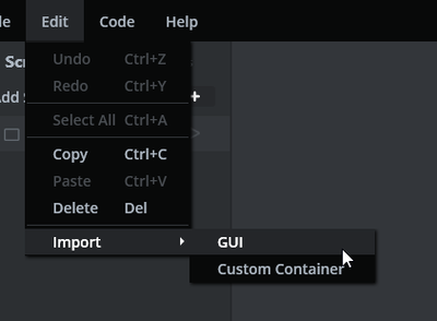

In that case, all you have to do is to create a new project from Designer if we provide TBS (TouchGFX Board Setup) for the new board + screen you want to use (that is the case for the STM32F769-DK).
You will end up with an empty project, but you can easily import what you previously designed by clicking on "Edit" => "Import" => "GUI" and then simply selecting the .touchgfx file of your previous design :
