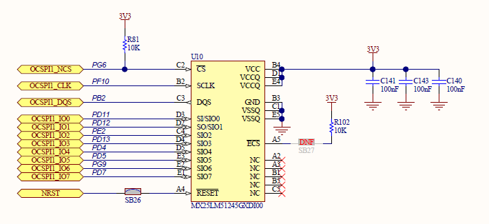

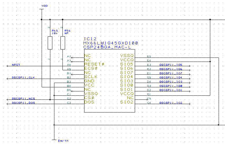

I'm using a STM32H735IGK6 processor with a MX66LM1G45GXDI00 flash memory (couldn't buy anything similar to the memory on the dev board).
I cant find a loader for this memory device online so I need to tailor my own but finding it hard to get any data on how to do this.
Has a tutorial been created for this yet?
Or is there any guidance on do this with an octospi interface?

What pins are you using on the H7?
https://www.macronix.com/Lists/Datasheet/Attachments/8748/MX66LM1G45G,%203V,%201Gb,%20v1.1.pdf
‎2022-05-06 2:23 AM
My connections are the same as the STM32H735G-DK board.
J13 PD11 OSCSP11_100

Extract from STM32H735G-DK schematic and my schematic.

I did observe that the OCTOSPI on the H7Ax/7Bx and H72x/H73x DISCO/DK are using different pins.
Can you access the memory via your own BSP implementation, reading out the JEDEC CHIP ID?
