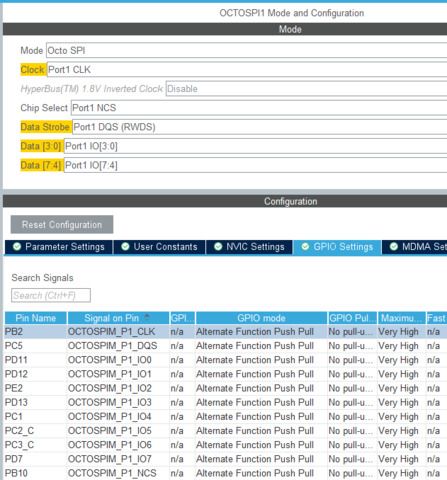

I am using below componnet tools
MCU: STM32H7B3IIT6
IDE: STM32CubeIDE Version: 1.8.0
GUI: TouchGFX Version: 4.18.1
SDRAM: IS45S16800F-7CTLA1-TR
FLASH: MX25LM51245GMI00 (OctoSPI)
I am using below pins
// STM32H7B3IIT6 PIN CHART
// MX25LM51245GMI00
// OCTOSPIM P1
// D0   PD11:AF9
// D1   PD12:AF9
// D2   PE2:AF9
// D3   PD13:AF9
// D4   PC1:AF10
// D5   PC2:AF11
// D6   PC3:AF11
// D7   PD7:AF10
// CLK  PB2:AF9
// NCLK NOT USED
// NCS  PB10:AF9
// DQS  PC5:AF10

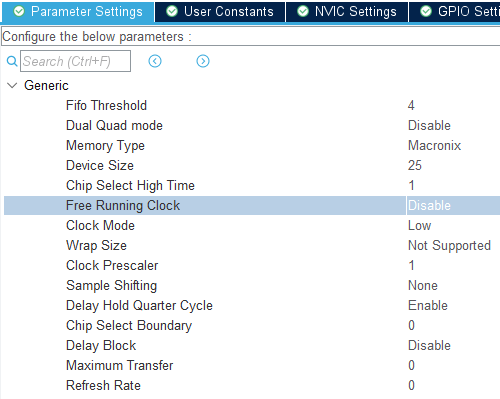

I am using below configuration
0693W00000KcDD9QAN.jpg0693W00000KcDDEQA3.pngThere is source for QSPI but dont have OctoSPI.

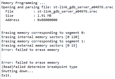

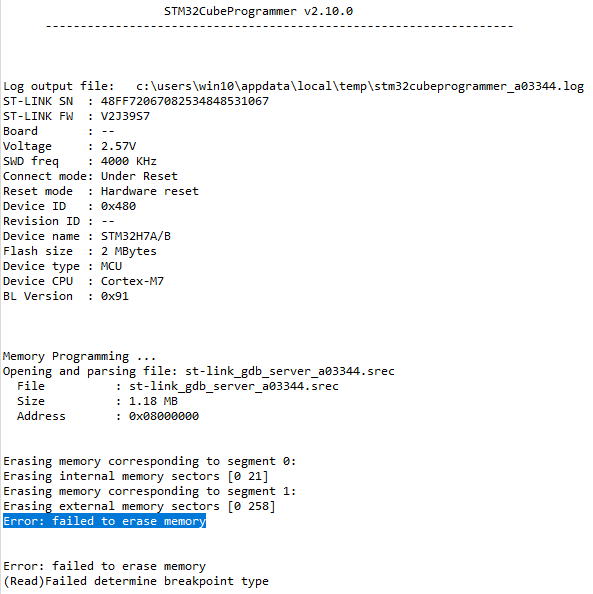

I created external loader for custom board. But it didnt work. I am getting below errror.
0693W00000KcCqzQAF.pngI shared external loader project file at attachment. Can you review it please? I need your support.

To test if OctoSPI FLASH works, I made my pin connections the same as the DK development board. I made the pin connections with jumpers as space mounts. Then I was able to load FLASH with the external loader of the DK card. OctoSPI FLASH worked.(Shows some data incorrect or missing due to jumpers)
MX25LM51245G_STM32H7B3I-DISCO-SFIx, 0x90000000, NOR_FLASH, MX25LM51245G_STM32H7B3I-DISCO-SFIx.stldr
