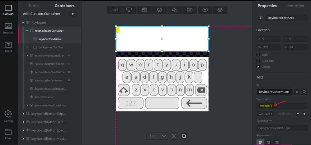

Hello heyo,
I'm not sure what you want to do. Can you be a more specific in your question ?

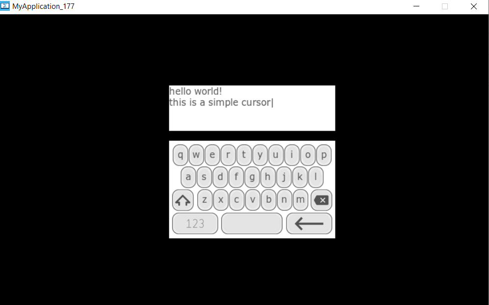

If you just want to add a cursor to your text, I'm going to say to simply use the vertical line symbol ( | ) at the end of you text like this :
I'm using the keyboard widget shared in this post and I only modified the TextArea to add the vertical bar like this :
/Osman

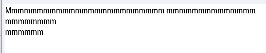

@Osman SOYKURT​ also I use textArea.setWideTextAction(WIDE_TEXT_WORDWRAP_ELLIPSIS_AFTER_SPACE); function. Is it possible to know when text goes to next line?
‎2022-10-12 1:02 AM
We don't have a particular trigger for that in our API, but this is easily doable with an handleTickEvent() function combined with a getTextHeight() function. You first get the text heigh of your text when your application starts and then compare the the current height with the original height

@Osman SOYKURT​ This function "textArea1.getHeight() " returns defined textArea1 height, so its always be the same and does not change.

And btw, if your TextArea is "autosized" then a getHeight() won't be the same if you change if you add lines.
