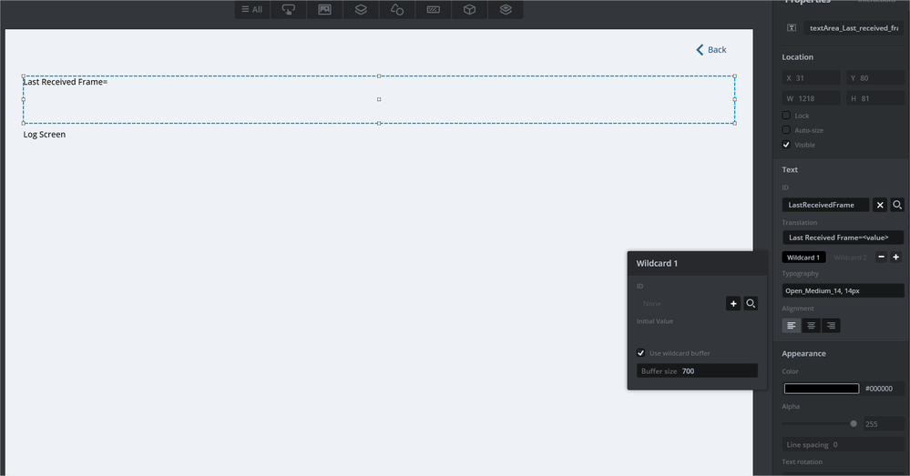

I'm experiencing some flickering of the images when I'm changing screen (on the real screen) (some images stay at the same place in several screens so they do not appear during the transition).
----------------TEXTS---------------------
I'm also experiencing 2 different behaviors for the text (staying in the same screen here)

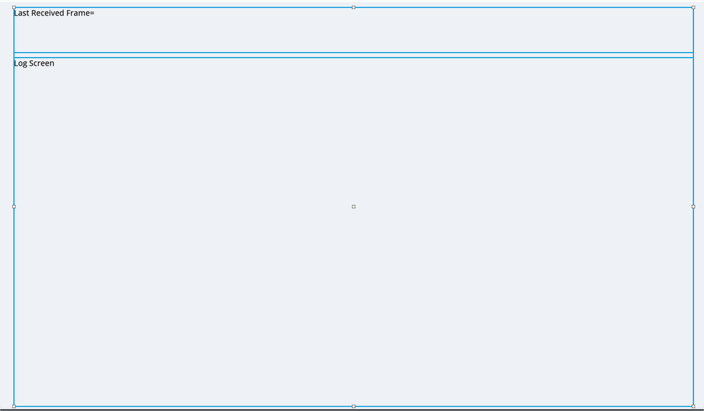

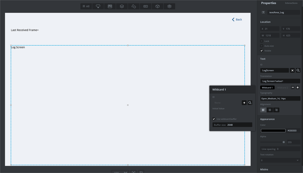

I have a screen with 2 texts zones, one small and one big and the biggest zone flickers when I update it with invalidate. The smallest one has no problem. They do not superpose.

void LogsView::dataDisplay()
	memset(&textArea_Last_received_frameBuffer , 0 , TEXTAREA_LAST_RECEIVED_FRAME_SIZE);
	Unicode::strncpy(textArea_Last_received_frameBuffer,(char *)Serial_Frame,strlen((char *)Serial_Frame));
	textArea_Last_received_frame.setWideTextAction(WIDE_TEXT_CHARWRAP);
	//textArea_Last_received_frame.resizeToCurrentText();
	textArea_Last_received_frame.invalidate();
	memset(&textArea_LogBuffer, 0 , TEXTAREA_LOG_SIZE);
	Unicode::strncpy(textArea_LogBuffer,(char *)HMI_Full_Log,strlen((char *)HMI_Full_Log));
	textArea_Log.setWideTextAction(WIDE_TEXT_CHARWRAP);
	//textArea1.resizeToCurrentText();
	textArea_Log.invalidate();
	Request_Update_SerialFrame=0;

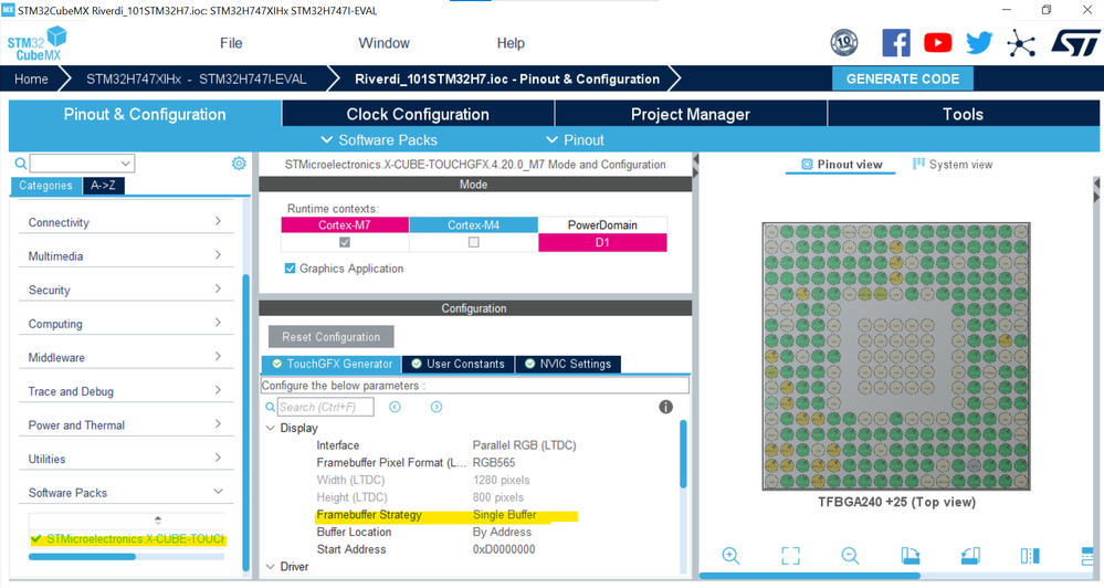

Use your code single or double buffer mode ?

Hello Eve,
The framebuffer strategy that MM..1 is talking is about your display configuration; if you open your project ioc file with STM32CubeMX, you can get this information. If it's a single framebuffer strategy, you can try to change it to double instead to prevent your flickering images. I invite you to follow this guide to change the framebuffer strategy.

You realy switch to double buffer ? How address1 and 2 used? Regenerated projects in TGFX and CubeIDE? ...
Where is stored your fonts internal or external flash, mapped unmapped mode ?

Maybe you need ask Riverdi, because i cant ask every step in complicated config for use SDRAM LTDC FLASH LCD DMA2D ... SYSCLOCK is too relevant to flickering , but most important is other clocks and combination of more clocks...
Try read apnote about LTDC optimizing LCD-TFT display controller (LTDC) on STM32 MCUs - Application note
For example for screen transition some types need more as double buffer config , configure it you can only in source code no in MX ...
Hello @Osman SOYKURT​ and @MM..1​ ,
I've managed to remove the flicker by going double buffer but using address 0xD0400000 instead of 0xD0200000.
