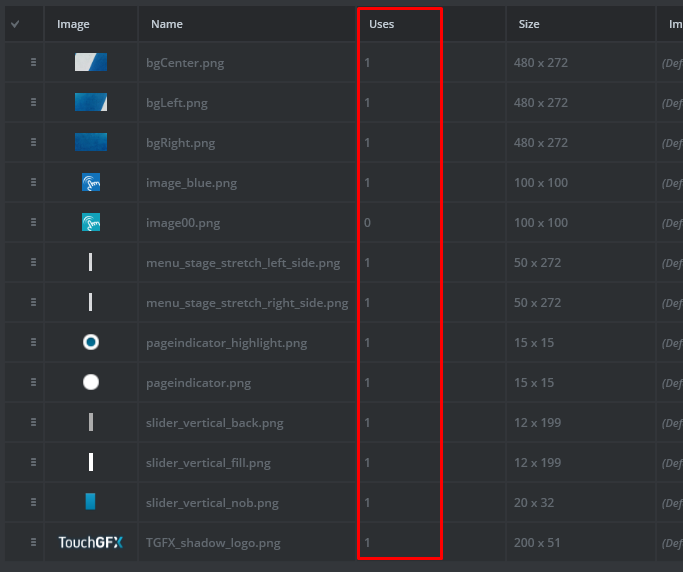

A lot of images are uploaded in to my TouchGFX project. I would like to removed unused images from there. How would I know if a particular image is used in the project or not? For example, Texts -> Typographies tab shows how many uses a particular font has. Similarly, is there a way to know if a particular image is used or not?

Simply check and search in code every image ID from database. Designer dont count about...
I thought about this approach. But this is a long and time consuming approach considering number of images in the project. I am trying to see if there is an easier way like the text fonts I mentioned above.
in header file for example
const uint16_t BITMAP_BL1_ID = 0;
const uint16_t BITMAP_BL2_ID = 1;
const uint16_t BITMAP_BLB_ID = 2;
const uint16_t BITMAP_BLW_ID = 3;
comment all out and build
you see errors on used IDs

Are you using the latest version of TouchGFX Designer (4.18.1) ?
Because the number of uses is clearly shown for images as well
0693W00000KbNVuQAN.pngWhen your question is answered, please close this topic by choosing Select as Best.

Good to know the feature exists in v4.18.1.
I check this in 4.18.1 and counted is only images used in designer. I have many images used from code and show Uses zero.
Hello MM..1,
You are correct, and I'm glad you mentioned it since it could also be mentioned by other people ^^
The Designer does not read your user code so it is normal that the number of uses from code is not recognized by the Designer.
