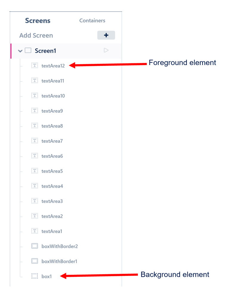

Otherwise, in TouchGFXDesigner, the order in which you place the elements in the "widget list" has an influence on which the element is in foreground or in background on the screen. For example :
Hope that this helped you,
