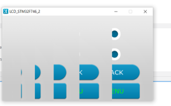

2020-02-12 10:19 PM
For me while screen transition, drag I can see, completely first screen is not going, when second screen comes . What to do to resolve this
